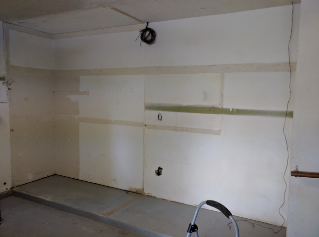

We have had the house now and finally have finished moving. Even the GF's mom down from Payson. Now the fun begins to find a home for all the crap we moved in. My first task was to make room to put shelving in the garage. So some demolition was in hand. Here is what we started with.

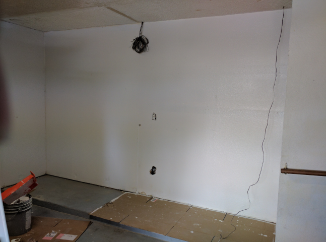

Once we had everything out this is what we have. An area about 8' tallx3' deap and 12' wide.  :good

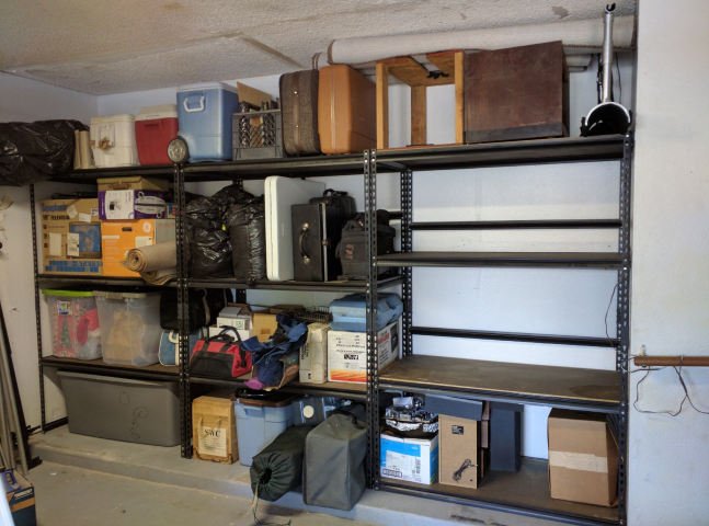

Once done and the 3 shalving unites I bought for $105. The are 2'deapx4'widex6'tall. This too a lot of the crap off the floor and out of the way for the next wave of destruction. The open shelves on the right are for any boxes that need a home from inside.

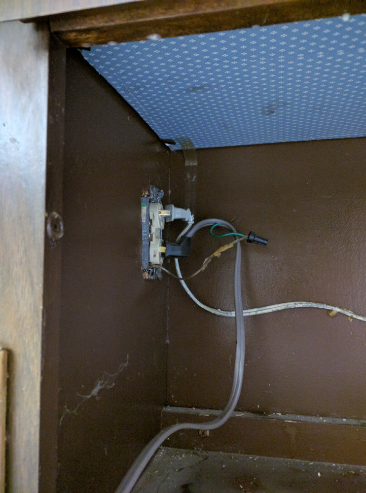

OK Here is what was found in the Kitchen. I think I posted these before but want to put all this in one thread. The cord running down and out of the picture is from the micro wave, I just pulled it out and set it on the counter to see this mess. Good idea but bad execution of power supply and lack of space needed.

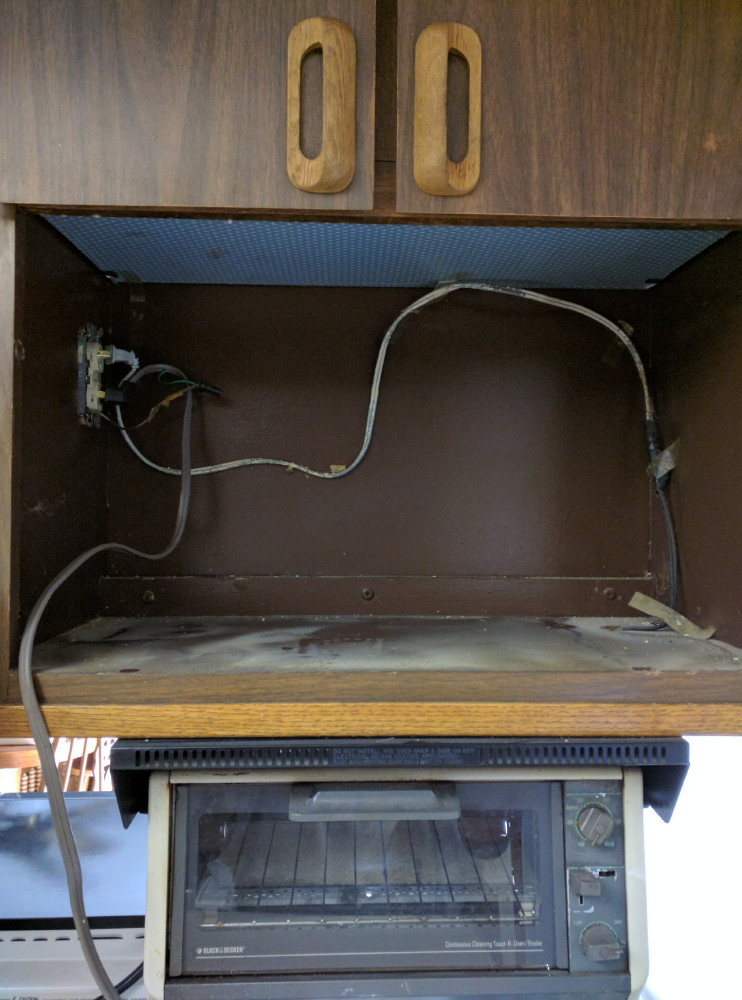

Here is a closer look at the plugs. Note the green wire coming out of the grey cable. Thats the ground wire for the microwave that was split and a wire spliced in that went behind the outlet and was grounded to the metal J-box. This is just as it was once the micro wave was out. OH and as I was pulling the micro out, the toaster oven mounted to the bottom of the cabinet came on.  :eek  They took the power coming down from the vent hood and swung it over to the outlet. Then took a peice of romex back over to where the original cord should have gone. Then took ANOTHER length of romex to a light on the other side of the hood. I took it all out and rerouted it all back to where it should.
See the tack paper on top. Thats in every cabinet in the kitchen. They even wrapped the vent tube, inside the doors and lined the drawers with this stuff. That will go when we are able to redo the kitchen.

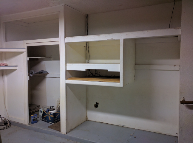

Forgot to mention. Back in the garage. See the hole in the wall mid way and low. There was a piece of romex that was tied into the outlet that faced inside that went down and under the drywall then out. Then was routed to the left and wire nutted off. That was removed. At the top in the middle and to the wire hanging at the right is a bunch of speaker wire. I will remove all that once it cools off and I can get into the attic. Inspection of power to the rest of the garage will be done at the same time.
