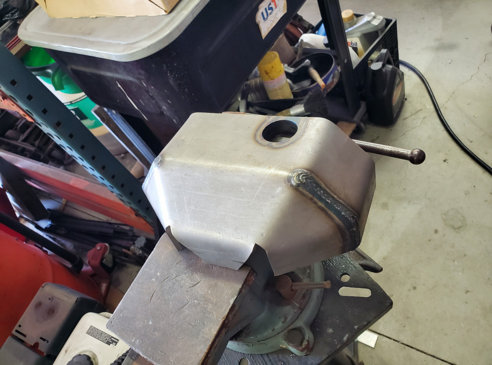

Figured out my cell phone pics must be too big so lets try this.

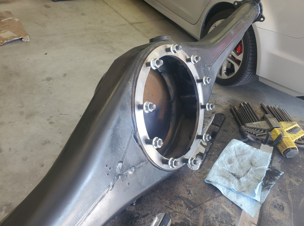

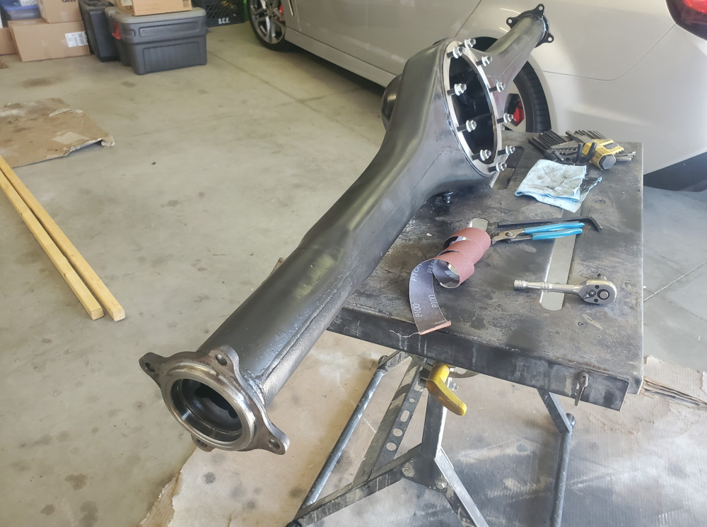

Here is the housing with the spring perches torched off and smoothed.
Post Icon Posted: Oct. 03 2024,2:45 pm Post # 12 see this member send this member a private message  quote this post in reply

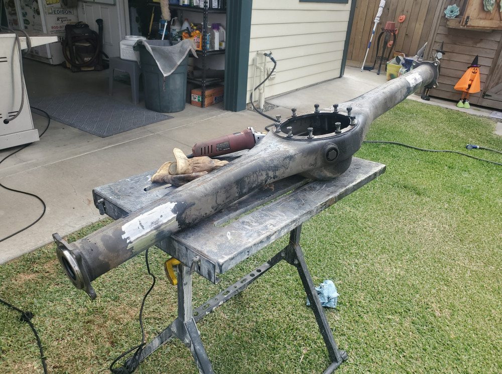

Cleaned up and painted, not final, just for temp mock up.
Edited by stingray on Oct. 03 2024,2:47 pm

Pulled the factory studs and installed ARP Allen heads from inside out for strength.

And finally the next step with be to massage the rear armor to fit nice, and weld it on.

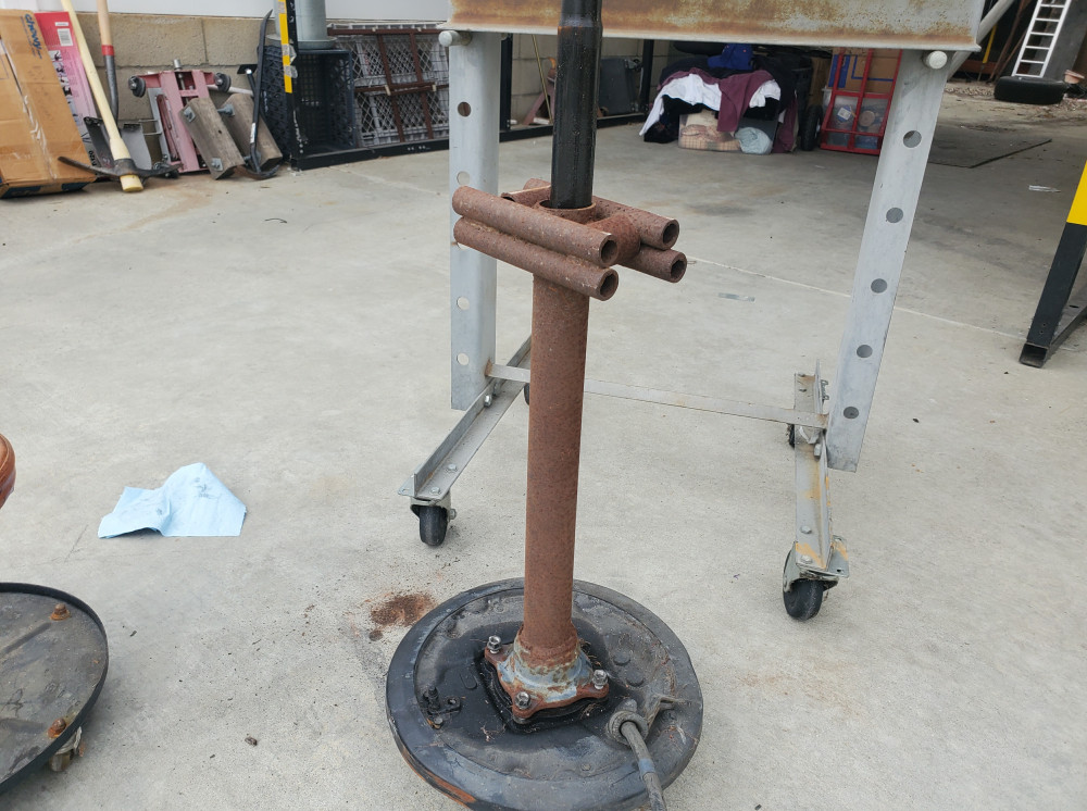

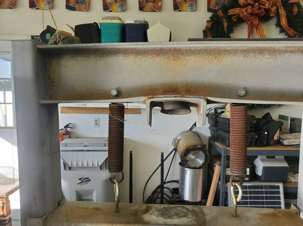

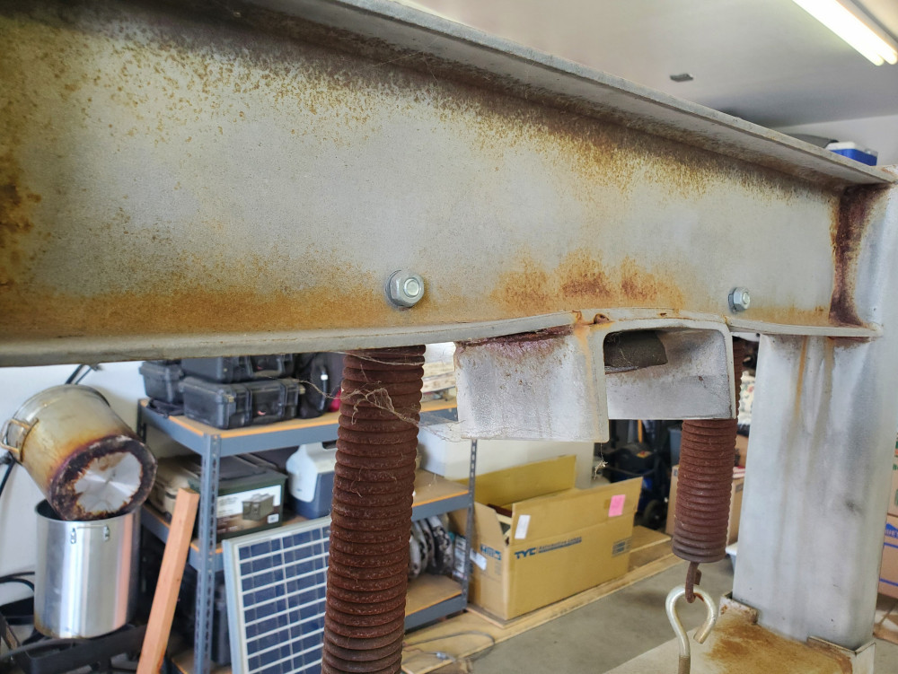

So I have a home made axle bearing press I made years ago by cutting the end of a bent housing, Its specific to Toyota  Don't mind the rust I got one done using my bent to hell 20 ton press.

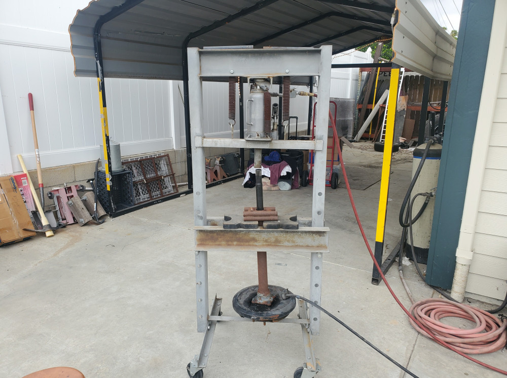

Set up in the press, But not going to be able to do the second one, My son bent my press and I don't trust straightening it.
Post Icon Posted: Oct. 19 2024,6:07 pm Post # 19 see this member send this member a private message  quote this post in reply
Kid was pressing bushings out of his radius arms and was using a sleeve that was too large and had the press maxed out. I thought I had taught him how to use it, but apparently not, He's lucky he didn't get hurt, Lesson learned
Post Icon Posted: Oct. 19 2024,6:09 pm Post # 20 see this member send this member a private message  quote this post in reply
I'll cut the head out of it and downgrade it to a smaller jack, I dn't trust my skills at 20 tons. :stupid

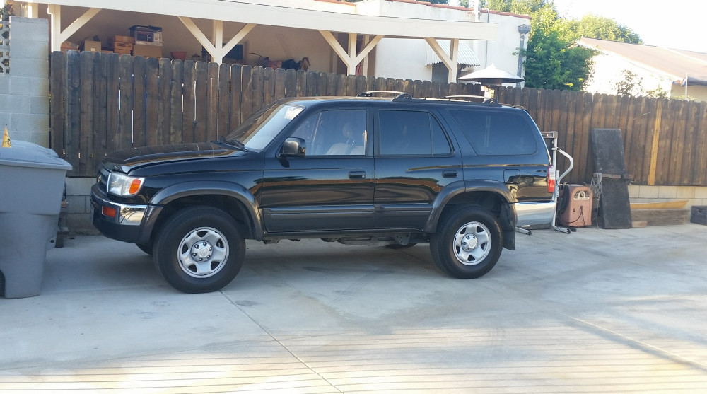

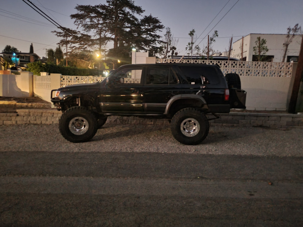

1997 4wd Stock Toyota 4runner
Post Icon Posted: Oct. 19 2024,6:57 pm Post # 23 see this member send this member a private message  quote this post in reply

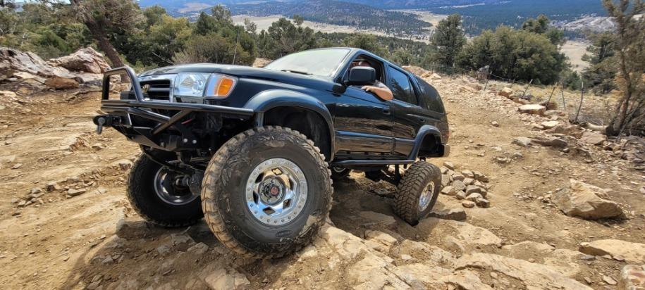

14 months later I torched off everything from the frame rails down, and went new, way too much to list.
and went from a 29" tire to a 37" what was I thinking?? :rotflmao

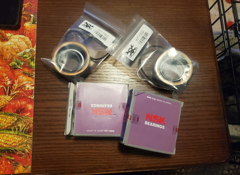

new axle bearings showed up, this will be tomorrows project
