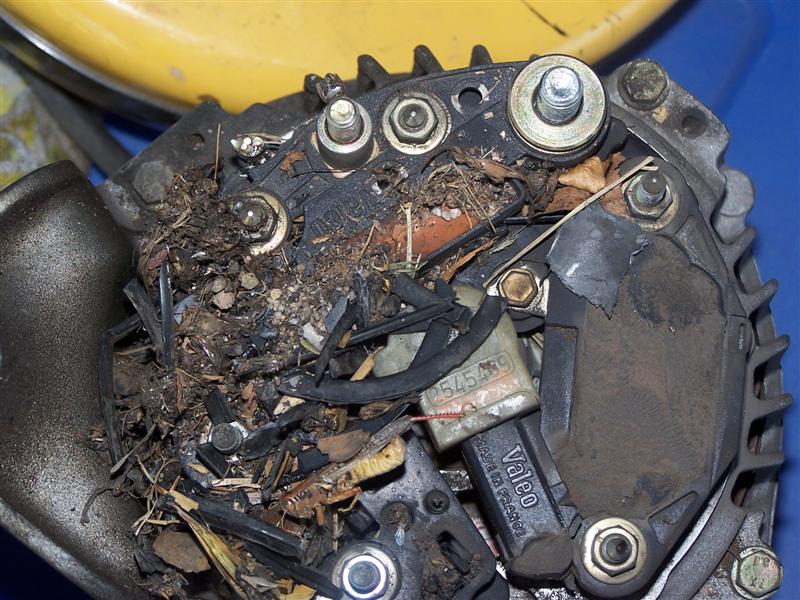

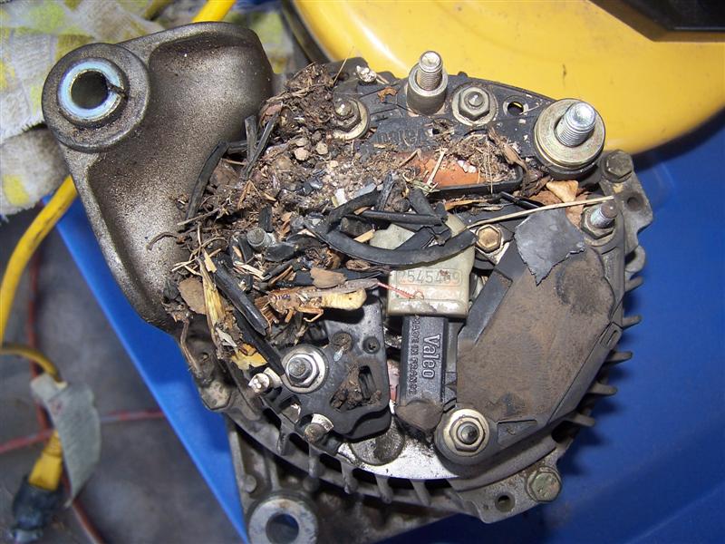

Oh Yeah :D The car has a air cooling duct that is supposed to help cool the alternator, runs from up on top of the radiator down to the back of the alternator. Pretty neat idea, except for this :eek Found all this under the cover on the back.
:jawdrop
Edited by AZKC on Mar. 15 2008,12:35 pm
Post Icon Posted: Mar. 15 2008,12:33 pm Post # 7 see this member send this member a private message  quote this post in reply
:banghead Thats about 13-14 years worth of critters and crap :puke

I've been looking for parts for an hour or so now... can't find new brushes or rectifiers for the Valeo alternators.  You can get new voltage regulators for them, but they are a C note at least.  Take that new rebuilt POS back and swap out the regulator on the old one, I bet it works.
Now if it was a Bosch... parts for those things are all over the place...
