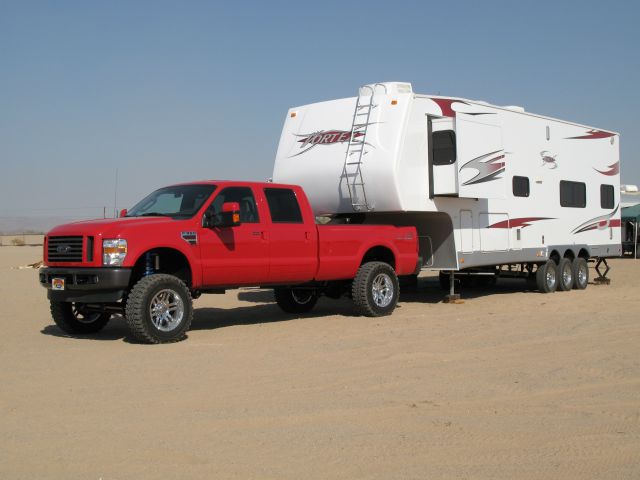

So we just sold my husbands F-150 yesterday :jumpie  (poor thing is headed for a rough life in Mexico- yikes!;).  Besides the fact that the F-150 was getting too old, our main reason for getting rid of it was that it was useless for towing our toys.  It was strong enough to pull the pontoon, as that doesn't actually weigh that much, but we never did because it just strained it too much.  Pulling the 34' Tailgator 5th wheel was never, ever an option.
We want a 2500 HD and have found several trucks that we like, both new and used.  The two used ones we are looking at have a 6" and an 8" lift.  My question is this:  If we get a truck with a significant lift does that affect our ability to tow our 5th wheel?  It seems to me that by lifting the front of the trailer the back end subsequently drops down and risks bottoming out.  Does anyone have any experience with this?  Hubby seems to think that we would have to get the trailer lifted.  I'm sure that I have seen some people with that, but surely not everyone who has a lifted truck and a trailer has had to get the trailer lifted....
Any input would be helpful!!!

I would Think That The Trailer Would Have To Be Lifted So That It Would Tow Level. My Thought Is, By Lifting The Trailer, It Would Also Lift The Center Of Gravity, Which Could Make It Interesting While Towing In The Wind....
Post Icon Posted: Mar. 20 2008,7:32 am Post # 3 see this member send this member a private message  quote this post in reply
The trailer should be lifted also, if not there will be more weight on the rear axle which will also make for pour handling and more ware on the rear tires than the front. The weight is not dispersed evenly like it should be!

Typically you flip the axles on the Toyhauler.
On the way home from Ocotillo we saw a lifted F350 with a fiver that had the axles flipped. Towed pretty level, but it sure does look a bit hinky so high up there.
I prefer to keep it a bit lower myself....
Many guys lift the trucks and slap big tire/wheel combos on there and don't touch the drive train or brakes and find them selves in a world of trouble on steep grades.
You can flip the axles yourself in an afternoon.  :good

Exactly, the axles need to be flipped on the springs. I personally think it looks funny and as stated it brings the center of gravity much higher. I wouldn't want to tow it in much of any side wind.
That much lift on a truck used 95% for road use is a waste. Might look cool(pimp factor :p ) but it alters several dynamics, stability and most certainly fuel consumption. When I was a bit younger I wanted to lift my truck like that but my brain told me otherwise, I ended up replacing just the front springs in order to make the truck ride level.

Here's a pic of a raised rig w/ flipped axles:

I didn't know how well they work, seen alot of short beds with crunched cabs!  :eek
the sliders work fine. You probably saw guys too cheap to but it though.
With a 35' 5'er a longbed is probably a better idea anyhow.
I never cheap out when it comes to towing, everything has to be right..
I agree, I like to error on the side of caution.  But it all comes down to how much you actually tow.  If you go to Glamis twice a year, get the lifted truck w/short bed, looks cooler.  But if you're towing that 5'er every weekend, a stock hight long bed will make life alot easier.
I guess I past the needing to look cool part of life, I'm more function before form now. Limiting liabilities is important to me.
Can't remember the last time I washed my truck :stupid  :laugh
It rides on 35's and formerly polished Alloys :)  :p
Hmm, so you are one of those old men who has given up, huh Zig?  Do we need to start reminding you to shower daily too? :laugh
I haven't given up, it just isn't all that important to me anymore, I guess. It costs alot to impress other people :laugh
So long as I'm happy that's what matters to me.
Are you offering to spongebathe me? Daily? ;)  If so then yes I need the reminder  :rotflmao
