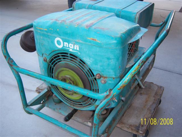

After working so many hours. I was able to take some time off to get the hell away from the "Job" and take care of  my mind and a project that has been at my feet for a few years. Here is a pic of a Onan generator that I bought 18 years ago. My wife used a few times painting houses. This beast powerd an industreal airless paint sprayer with out any bog at all.

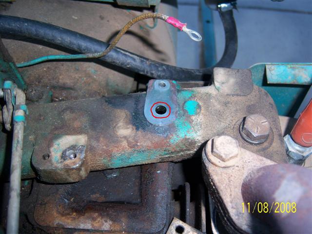

I tore it apart and made intake/exhaust gaskets. There the same gasket. Put it back together and still only running on one cylinder. So I made a gasket to go under the load control modual that senses the change in vacume in the intake. The hole circled matches a port in the intake.

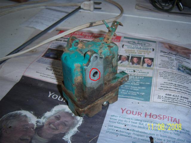

Here is the intake the above matches up to.

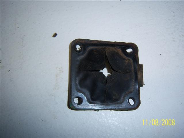

After making a gasket for this it still only had one hole firing. So I took the box apart and found the diaphram was a little leakey.

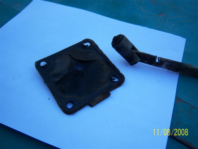

Here is the same diaphram. Next to it is a rod with a round peice that should be on the center of the diaphram. This is what controls the throttle. When the engine is placed under load it will raise the RPM. You can also see that the pivot rod is warn through.
