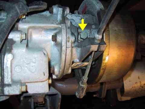

Does it look like this?

Quote (GlassMan @ Mar. 18 2009,9:29 am)
Yep...  :good

Then this will help:
http://www.zbag.com/PDF/parkingbrake.pdf
:cool
Post Icon Posted: Mar. 18 2009,10:18 am Post # 16 see this member send this member a private message  quote this post in reply
Quote (GlassMan @ Mar. 18 2009,10:14 am)
:cool
Yes it does... thanks..  :beer  :good
