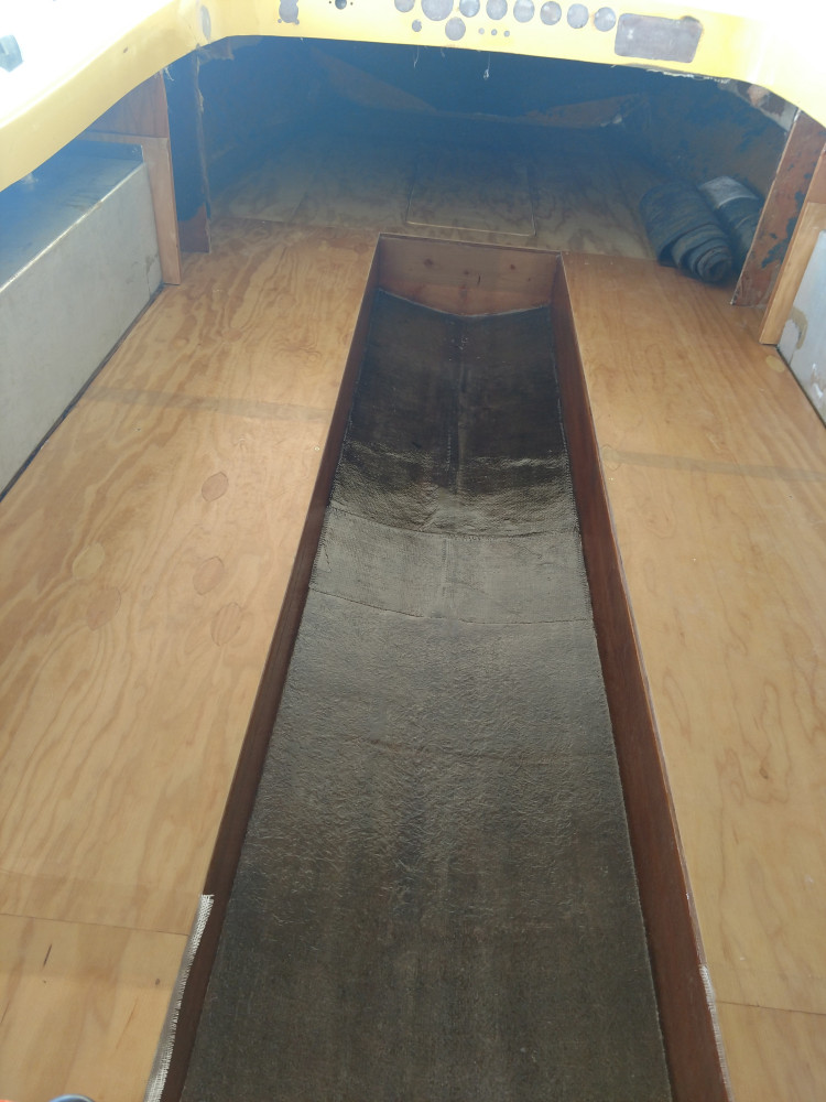

Has to be completely rigged not one hole in the boat. :D First thing gotta redo the bottom.
