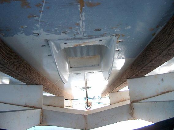

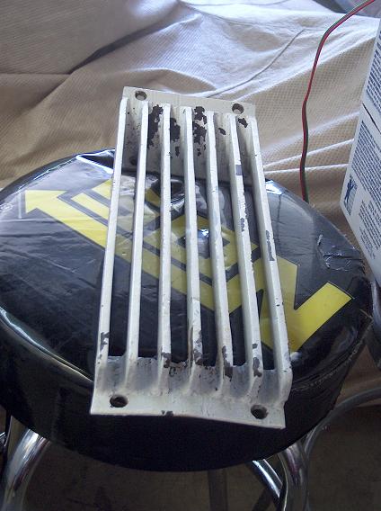

After dealing with it's little eccentricities (blowing out the pump when I open the secondaries and unloading at speed), I finally crawled under to see what was up with the rock grate, and this is what I found.
It's really no surprise now that it does what it does. That thing is more of a ramp to LIFT the intake than anything. It does a great job of keeping rocks out... it does a great job at keeping WATER out too! Here's a shot of the intake. Note how flat the front of the intake is.
I'm pretty sure a standard JC/G loader will bolt in, but if anyone local has one I can check fit with I'd appreciate it. It'll probably need a little more bite than other hulls, but if I can just get a handle on it blowing the pump out I'd be happy. BTW, it's not the rear main leaking  :bowdown , it's the intake. On a fe motor, either is a pain to reseal!

The Grate looks like a "Catch22" thing. With it, it adds alot of restriction, but without it, it's going to pump alot of debris through the pump....

I have an open loader on the Advantage and have not had a problem sucking anything up (knock on wood). I run this in the same stretch of river and don't anticipate any problems, so if a loader helps, I'm all for it. It gets REALLY good mileage though. Can't go over 40, only runs on the primaries (in effect, a 2 barrel carb), and it floats REALLY well! :D

Floating well is a good thing!!   :good  I don't know much about jets, how does a loader work??

Post Icon Posted: June 18 2007,10:30 am Post # 116 see this member send this member a private message  quote this post in reply
It directs water up into the impeller. On my Advantage, it is made to direct the water to the top of the impeller to keep it loaded at higher speeds. On this hull, instead of the water flowing past the intake (and starving it for water), I'm hoping it would take some of the water flowing past and direct it up into the impeller. That's the simple explanation... in reality it often takes much more trial and error to make it work effectively.

So It's Bolt On, Like A Grate, But It Redirects Water without Restricting it....

Yup. If I can't find one by this weekend, I may just run it without the grate and see if it helps. That grate has a whole lotta metal blocking the intake at speed....

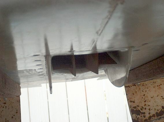

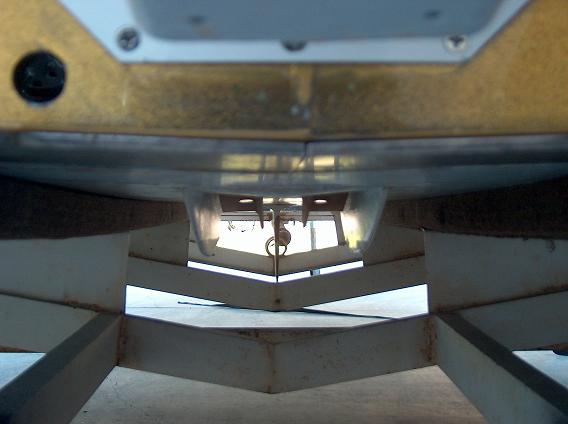

Here's the first step in my quest for speed (of course I'm kidding) This loader is a open ramp loader that has about 5/8" of bite. Too much? Hell, I don't know... I'll find out next weekend. The other loader is your basic angle iron loader and has even more bite than this one.

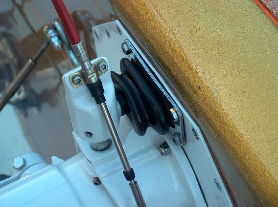

For months I have been trying to find a boot to seal the tiller arm to the transom. I found this boot that is made for a Jeep twin stick. The cool part is, it'll make 2 boots... spares are good with something this old
Here's the finished product. I don't know if this is how it looked in 1965, but it looks relatively OEM, and will keep the river out.

Success! We took the Stevens out yesterday and tried out the loader Vic loaned me. First off, the boot worked GREAT! No water leaks, and it's the first time out I felt comfortable just getting in and driving instead of constantly trying to identify leaks. Nothing worse than water leaks in a flat. The bilge pump is for show only, 'cuz if I have over 1" of water in it (how much it'll take before the pump primes), it's probably going down.
And how did it run? With 4 people in the boat, it unloads... period. I think it may be that 2 in the back lift the bow too much. I took it out solo and then with 1 passenger and it flat hauls. No unloading (except in chop) and runs around 45-4700 rpm. It's a different feeling.... the bow doesn't come up at all. When you nail it, it just goes immediately on plane and accelerates. On shutdown, there's no ill handling, but turning is impossible unless you jump on it again and crank the wheel. It takes a little practice crossing wakes in a flat, too. This one will be the weekday boat, 'cuz there's too much kidney damage driving it on the weekend.
