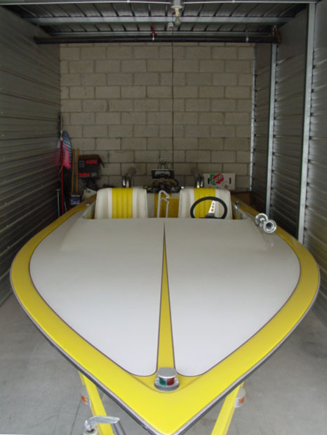

I guess I should have taken some pics of it today, but I don't recall any evidence of a hole.  I'll visit her tomorrow though and check again.  I haven't seen her in awhile anyway. :(  She's stored indoors, but not at my house.

When I rented a duplex, I stored her outside next to the garage.  I sat in her many days and nights thinking about the river, while drinking beer and listening to the tunes. When I rented a home and at the home I owned, I did the same thing while she was stored in the garage.  This house has too much in the garage already, so she's stored remotely. :(

Yeah I got some good news today.  Thanks Miller. :D  When I visited Miss American Pie in her temporary quarters, I found a fitting. I was dark and I didn't have a flashlight with me, but I felt where the fitting should be and it was there. :D
