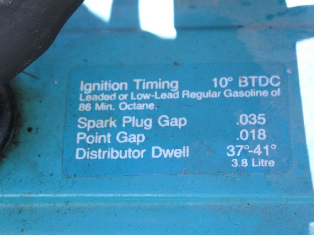

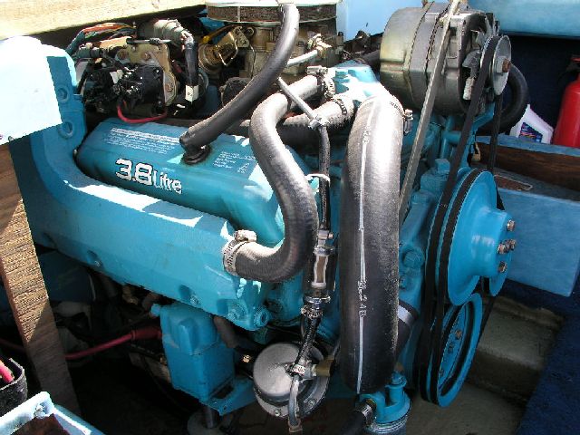

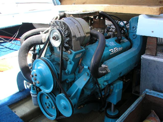

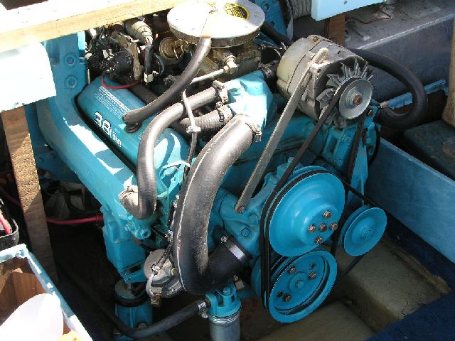

Ok since your the gear head of the HD board I thought I'd ask you first. I have a 1983 sunray 18ft boat that has been in the family since it was bought new in 1983 by my grandfather. I now own the boat and can't figure out what type of engine is in it. It's either a Buick V6 3.8 litre or a Chevy V6 3.8 litre. But for years I was told that engine in the boat is a Buick. I just don't know. The block to me looks like a Chevy but then again the fuel pump on the block is mounted upside down. Here are some photos I took of it today. Please let me know. I need to get points for it and a little tune up.... Thanks....

Post Icon Posted: Mar. 16 2004,5:07 am Post # 5 see this member send this member a private message  quote this post in reply
It's a buick but you find them in everything, I just threw one away a month ago, it came out of a Firebird, looked just like yours!.. Just look up 3.8 around your year and it should work!.. :good
CraigMale Offline
Driveless
Peoria, AZ
Posts: 103
Post Rank: 138
Post Icon Posted: Mar. 16 2004,6:15 am Post # 6 see this member send this member a private message  quote this post in reply
Actually that motor is a Chevy, Buick's distributor is in the front.

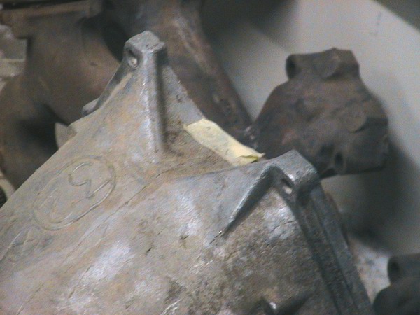

Can you see or feel little ears (there are two of them on BOP blocks) on the top of the block in the back where the bellhousing bolts up??
Post Icon Posted: Mar. 18 2004,5:49 pm Post # 22 see this member send this member a private message  quote this post in reply
This is what he's talking about but so far it's been determined that it is a Chevy, so it shouldn't have this bolt pattern!.. :rolleyes
