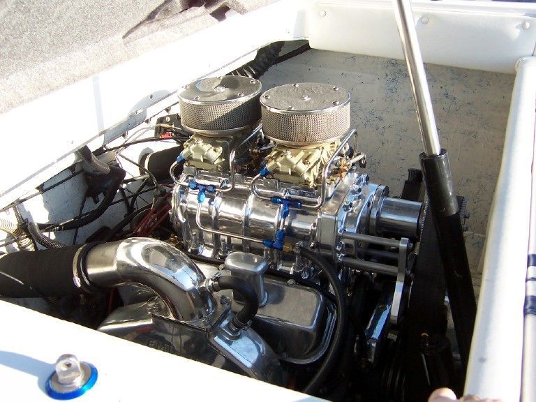

Well we need a lot more info on the motor(compression,cam specs, timing, fuel system, jetting etc.) to pinpoint the problem but I'm guessing here that you were on a melt down under load and the fuel delivery is part of the problem. You may have cooked a valve is the reason blowing out the top?. Water in every cylinder could be from several things!. Sounds to me that this was put together just to sell,(I've seen this many times) I looked at the pic and a red flag popped up instantly!.That funky fuel line is a dead giveaway, nobody would put something like that on something that looks that good. Everything is polished on there but the idler bracket spacers, why!..My advice would be to tear the whole thing down and go through it from top to bottom and make sure it's right, it'll save you a whole bunch of money and grief!....

OK Motor junkies....Here it is:
I dropped off the boat this morning in Corona hint???Hint???
They tore down the motor: Heres what i saw: They took off both heads Even bank, # 2 is dead intake valve "tuliped the valve" So why did this happen i asked??? LEANED HER OUT Â Checked fuel pressure from the "new" black holly fuel pump Well turns out 3 psi was pumping out......Should be no less then 6-7 i guess with this application. So when we were running 35-40 no worries motor was fueling fine then we get into boost and higher RPM's we sucking fuel from nowhere...boat stops dead in the water regression floods the exhaust headers and wamo you have this story....
