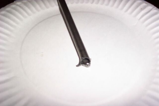

weirdest sh!t :break #3 intake pushrod rocker end broke :stupid
Post Icon Posted: July 04 2004,1:17 pm Post # 2 see this member send this member a private message  quote this post in reply
Oh but wait theres more :guns found both pushrods bent on #7. So now I best ck the rest of them :stupid  :banghead I'm kinda stuck on what the hell is causing this. The pistons are flat tops, the valve adjustment is on the loose side of the scale, can the push rods just bend under a load :confused without having somekind of interference issues. These bent at around 3000-3500 rpm  :drama
Post Icon Posted: July 04 2004,2:17 pm Post # 3 see this member send this member a private message  quote this post in reply
Well I also found #5 had a bent one also, the other bank 2,4,6,and 8 seem fine. But I did pull the #7 plug out and its pretty hammered the tip is gone and the electrode is mangeled, guess its time to yank the head and see whats going on in there :stupid To hot right now maybe in October :drink  :laugh

I'm gona yank the head today and take a looksy inside #7 cylinder I think I'll find some valve damage :banghead
Pretty doubtful on the timing chain dealio there Roberto it only has about 10-15 hours on it. I am going to re-ck the cam dial in and verify TDC is TDC :cool
The bent push rods I think were after the fact. The broken tip on the #3 hole now that one has me a little worried :stupid

Well I came home and popped the intake off and peeked in the intake port of #7 and the valve guide is missing a chunk so that valve is bent for sure :cry Which I pretty much knew allready :beat I'll get the head off tomorrow and see if the head is salvageable.
Something I picked up on today which need more verification is the Comp Cam 940-16 springs are said to be good up to .500 lift, they sold them to me for a cam that has .570 */-
lift.
And a question why don't all of the cylinders have the same problem?
When I set the valves I 0 lash them then 1/2 turn which I have heard is a little loose on roller tip rockers. Should I retard my cam 4* next time. I'm going to get Comp on the phone tomorrow morning and pick their brain abit :phone
