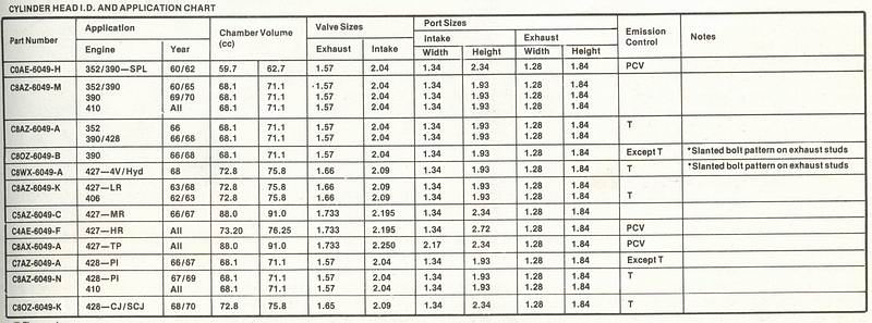

Here's a chart I dug up of head part numbers hope it helps!..BTW, if those are GENUINE 427's and the guy knows what he's got, be prepared to dish out the $$$$$$$$$!... :D

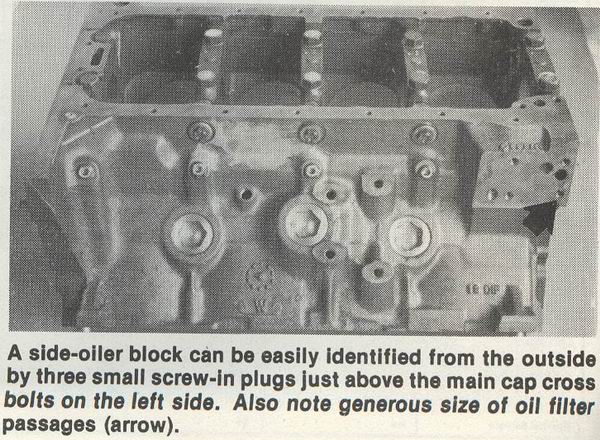

Here's what a 427 side oiler block looks like, this is the only way to tell what block they are!.. :)

The 390's bore is too small for 427 heads, the valves hit the block, the CJ's will work though!...My first boat had a 390 in it when I bought it and it ran over 70 and it was a mild motor, nothing wrong with them in a boat!..But yes, the cost is outrageous compared to a Chevy, and the fact that it's getting harder and harder fo find the good stuff for them!. That's why when Ford discotinued the FE, I went to Chevy!. :rolleyes
Post Icon Posted: July 31 2004,8:49 am Post # 25 see this member send this member a private message  quote this post in reply
Quote (GoFastRacer @ July 31 2004,6:16 am)
Oops, you're right Art. I was thinking standard 428 and typed in 427. :banghead
The Ford BB engine parts are getting so hard to find because restoring '64-'73 Mustangs is huge stuff these days. Some guys are even using truck 390s because they can't find GT390s. Try to find a Boss 429 cammer. It's just like before Chrysler started offering up the 426 Hemi again. If you can find one, plan on spending $15,000 for a short block up to $25,000 for a complete engine. :stupid
