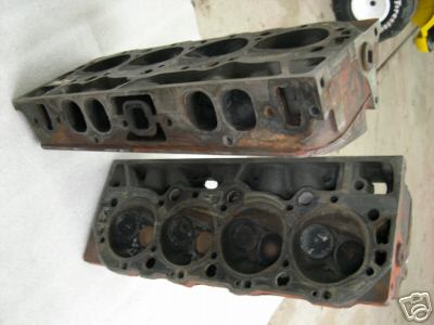

So its time to start working on the boat again. Picked up a set of "virgin" 049 heads off Ebay. Have the stock bore short block. We'll get all the pieces together and try this one more time. Actually this maybe left to the Pro's this time Becky's getting tired of paddling. :beat :banghead   :laugh

If I decide to go with bigger valves...2.19's & 1.88's do the seats have to be changed or can they be cut that big :stupid
Post Icon Posted: Sep. 21 2004,10:27 am Post # 5 see this member send this member a private message  quote this post in reply
No problem, I did the same thing. There will be a slight lip left after the cut and all that needs to be done is to blend it in when you do a clean up on the ports!.. :good
Post Icon Posted: Sep. 21 2004,12:39 pm Post # 6 see this member send this member a private message  quote this post in reply
Lip :stupid In the combustion chamber or back behind the the valve face :confused On the intake or exhaust :confused
Post Icon Posted: Sep. 21 2004,12:55 pm Post # 7 see this member send this member a private message  quote this post in reply
Do 049's run the hardened exhaust seats??  Might just be easier to have new seats cut in as it is.
Post Icon Posted: Sep. 21 2004,2:50 pm Post # 8 see this member send this member a private message  quote this post in reply
Quote (AZKC @ Sep. 21 2004,12:39 pm)
The valves won't be sunk in, that lip will be right behind the valve on both, it's part of the port!. :)
Post Icon Posted: Sep. 21 2004,2:52 pm Post # 9 see this member send this member a private message  quote this post in reply
Quote (Sleek-Jet @ Sep. 21 2004,12:55 pm)
Nope no hardened seats on those, but they could be put in no problem!.. :good
Post Icon Posted: Sep. 21 2004,4:43 pm Post # 10 see this member send this member a private message  quote this post in reply
Well then, will 2.25 intakes fit in a 049 with 1.88 exhausts :stupid
Mores Law....... "If Some is Good, More is Better"   :jumpie
Post Icon Posted: Sep. 21 2004,8:18 pm Post # 11 see this member send this member a private message  quote this post in reply
Sorry wrong theory :laugh that would work if you had square port heads and zinging the motor 7500. If you did that with the ovals you would have to do extensive porting to make it work and then it would still be out of your rpm range. Go with the 2.19 and 1.88's and do a clean up on all the ports(especially the exhausts) and polish the chambers and you will have a torque monster up to 6500!.. :)  :good  :good
