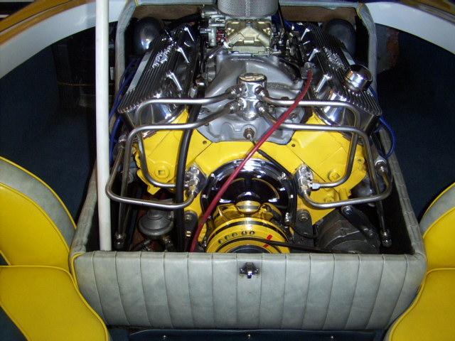

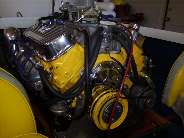

Well I finally did it. I decided to re plumb my lines to hard wall stainless. Boy was that a pain in the ass. What I thought would take a few hours took the better part of the weekend. But it is done now.
Oh art you will be happy to know that the engine cover still fits with the new lines  :D
Before:

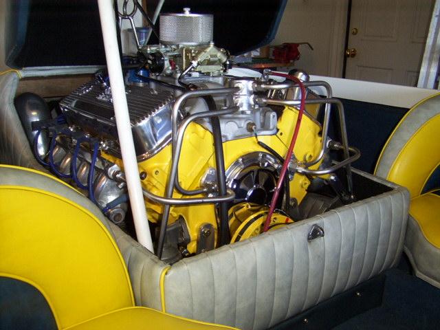

After:

After:

Nice work Brad, a few more details on how you did it please :bowdown  :bowdown

Hey is that my PVC pipe holding up your hatch :laugh I have a patent on that :D
