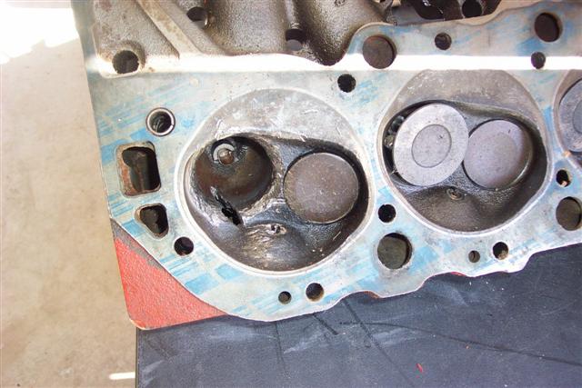

Well I tore open the boxes off the heads I bought of Ebay awhile ago and the guy I got them from can break shiit just as well as me :break
Edited by AZKC on Jan. 30 2005,12:42 pm

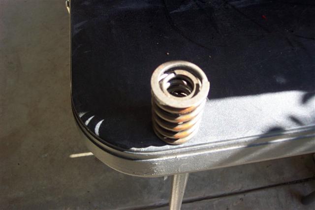

The other one is in great shape and its match ported 049 with big valves and triple springs. Now how hard is it to use one of my good 049's that I have and match port it to match. Also I want to ID the springs that came with them they are all in good shape. They have some orange stripe marking and they are triple springs like I said before.

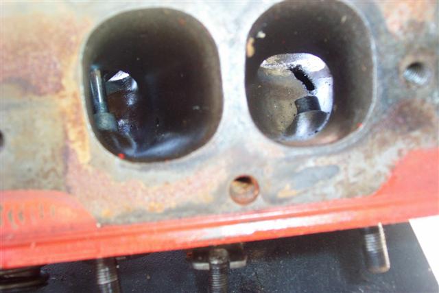

Here's a pic of the porting job with other carnage inside the pocket :eek

It's no big deal to match them it just takes time. I use one of these $3.50 dividers or you can make thin cardboard disks of the ports and grind the head to match, use the gasket to match the entry!. From the pic it don't look like they were hogged out though just a clean up and blend the sharp edges!.. :stupid
As far as the springs goes, there's only one way to find out what you have and what shape they are in and that is to use a spring tester to measure spring pressure, first to see if they are all equal, second to see if they are compatible with your cam!. Unless you have a spring tester, I'd take the whole pile and take them to Larry and let him check them and come up with a good set. This is the only way to find out what you have. You don't know the history of them, if the motor got parked for long periods at a time without backing off the valves they don't last long, when springs are compressed they lose tention pretty quick!.. :)
Yeah I figured taking the springs to a machine shop would be a good idea to see if they are still in good shape. Yeah the intakes were port matched and smoothed no real heavy grinding done to them. They really didn't do much to the exhaust ports though, smoothed a little but not gasket matched. The calipers look like stuff we used in wood shop :p But the cutting disc templates sounds like a plan what do ya think one every 1/2" or so

396 on hotboat had them checked out and found some small cracks somewhere in a valve bowl, and didn't want them.  I knocked $100 off of what I sold them to him for because of that.  I didn't see anything and my boss who is a big motorhead looked at them and didn't see anything, but said it's common on BBC heads and won't hurt anything.
Believe it or not those calipers are damn accurate, you can go an 1/8' at a time if you want. But yeah making discs work good, 3/8" to a 1/2" apart will work just fine!.. :good
