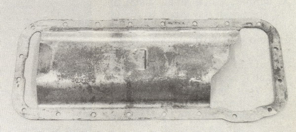

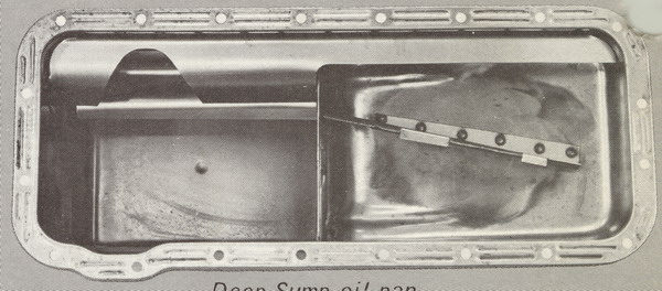

Post Icon Posted: Feb. 04 2005,10:19 am Post # 16 see this member send this member a private message  quote this post in reply
Well if it don't have a scraper then you don't have a 427 pan unless somebody butchered it up!. How many quarts does it hold?? It should have 7 with the filter!.. :good

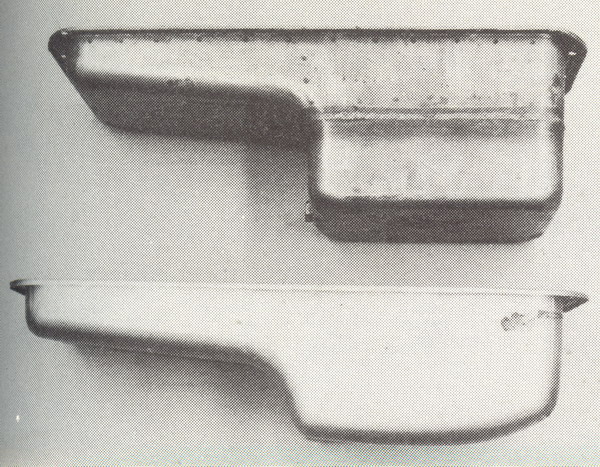

Post Icon Posted: Feb. 04 2005,10:32 am Post # 17 see this member send this member a private message  quote this post in reply
This is what it should look like, the stock one is on the bottom 427 on top!.. :)
