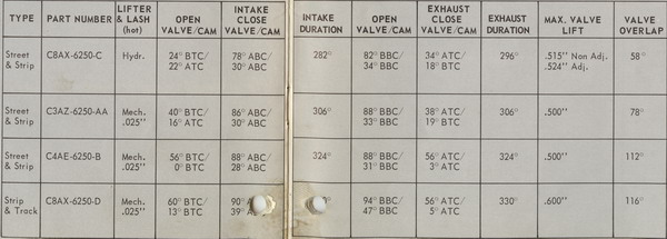

Quote (Sleek-Jet @ Feb. 02 2005,2:19 pm)
That's as close to the factory "B" cam as I could find.   In fact I never could find the specs on a "B" cam.  Lunati lists a OE grind for a "C60Z-B" 428 CJ cam as being pretty close to the Crower though.
The 'puter actually puts the HP over 400, but I've found that the D/D is a little optomistic at times.  So I figure I'm looking at around 380 - 390 hp with this cam.  That's what I mean by high 300's on the hp.
If I go over 220 on the duration, without being able to change much more on the engine, than the torque falls on it's ass.  That comp cam makes a shit load of hp, but the Crower makes more torque over a larger rpm band.  Also it's a solid, and I decided I don't really want to mess with that right now.  :D
Off the top of my head I don't know the gears or prop, I've got them writen down here somewhere.
Just dug up an old factory muscle catalog, this is easier to read!..Back in the day Crower did a hell of a lot of R&D with the FE and have about the best cams out there for them!.. :good
