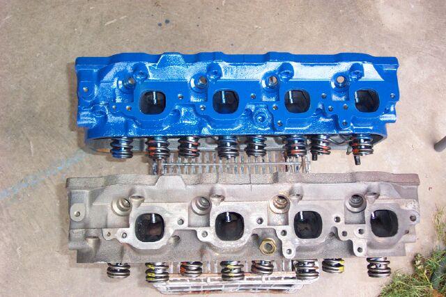

So got a little done towards building the next victim. I've determined piston to valve clearance has been the culpprit in the last two failures. So I have to get the heads ready to ck that out and I'll need the cam out of the DOA motor. First a little FoMoCo blue on the Cheby to match the block.

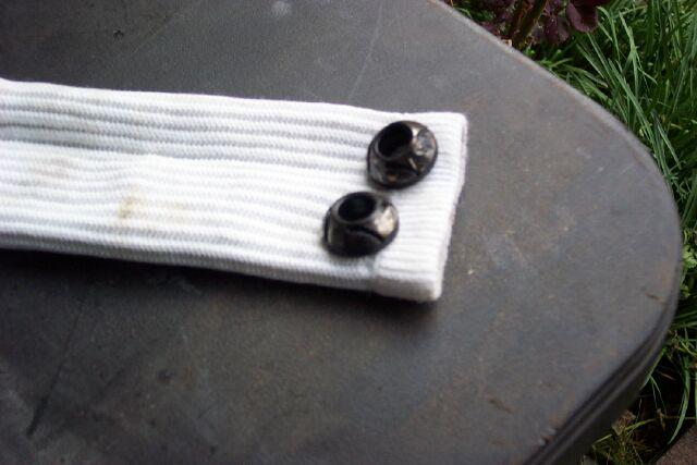

Then clean up the rockers and stuff, this is where I found a small problem for of the rocker arm pivot balls have scoring with one of them missing a chunk :( first time I've seen damage to these over the years :stupid

Roller rockers don't use those little nightmare pivot balls.   :)  :D  :good  :beer
And Ford blue on Chevy heads?  The engine is breaking itself out of spite for being cross-dressed.   :beer  :rotflmao

Quote (jordanpaulk @ Feb. 15 2005,8:14 am)
I run roller tip rockers :good , remember I'm not a big time baller like you :ass  :D . Speaking of rockers are 1.72 ratio stock spec.

Quote (AZKC @ Feb. 15 2005,8:06 am)
Can't believe you ain't seen that before, I've seen it many times it even happened to me, it's even more common with balls without the slots. That's what happens when you buy those cheap Taiwan rockers in a white box, the heat treating is out to lunch on a lot of those. Another reason for that is not enough lube at break in, motor wasen't prelubed enough before start up!.. :)

Quote (GoFastRacer @ Feb. 16 2005,5:34 am)
Well they are Comp Magnum rockers, and they were coated in moly assembley lube and I pre-lubed the engine 3 times cause I was having trouble with my oil pressure gauge.  :stupid
Well if you had oil coming out the pushrods when you prelubed it and they were coated with moly then I guess you just got stuck with some inferior parts!. :rolleyes
Post Icon Posted: Feb. 16 2005,1:21 pm Post # 20 see this member send this member a private message  quote this post in reply
Well I can't say that I had oil coming out the push rods :beat About how long would you have to pre-lube a motor to have that happen :stupid (and don't say untill it comes out the push rods :laugh ) I did it about 2 times for about 3 minutes, then 1 more time after I got the gauge working(80psi) and then a few minutes after that.
I'm going to ck with Comp and see if I can pull some warranty or something and have them replace the pivots. Also do they sell individual push rods or do ya have to buy a set?

Well it does take a bit to get the oil to come out the pushrods, never paid attention how long it took, :laugh  didn't care I just wanted to see oil flowing just like it's already been running. To do that you need to rotate the motor a 1/4 turn or so every few seconds so each lifter feed hole will line up with the oil passage, once I see a drool out of each one I figure it's good to go!. :good
Comp are pretty good about that stuff it's good for P/R!. The only thing is the rocker has to be replaced also since the ball and rocker was mated when broken in and it's not good to put a new ball in, similar to mixing lifters on a flat tappet cam!....If you buy direct from Comp you can get individual pusrods but I'd just buy a set and keep the others for spares, I always have some in the tool box never know when one might take a shit on ya, been there done that!. :laugh
