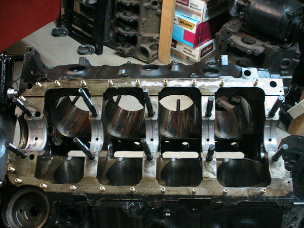

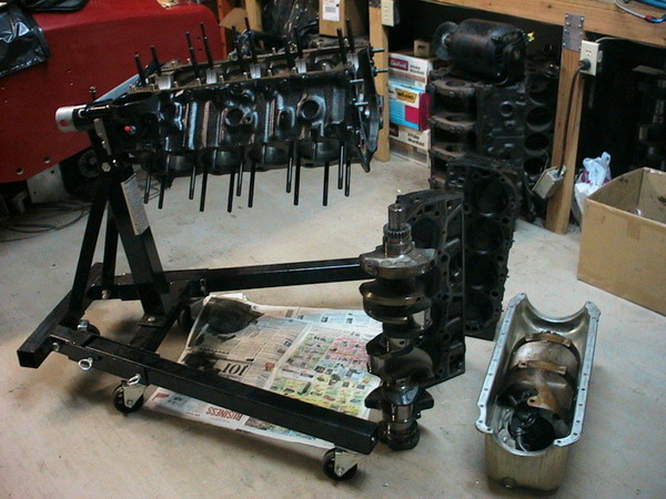

Well since good ole "Sleek" brought all this damn weather here and screwed up the Nordic project,  :beat  :laugh I won't have it done for Needles!.. :angry That means I'll have to take the Daytona!.. Sooo, since it's been 5 years since I built this motor and doing nothing but beatin the shit out of it, I figure I'd better take a look around in there. Well to my surprise everything was clean as a whistle, bearings look like they just came out of the box, cut the filter open and not one spec of crud!. :good  :jumpie So WTF do I do now :stupid piss on it I'll just put the thing back together and just keep on beatin the shit out of it!.. :good  :jumpie  :laugh
Post Icon Posted: Mar. 06 2005,6:53 am Post # 2 see this member send this member a private message  quote this post in reply
Everything looked nice and clean! :good
Edited by GoFastRacer on Mar. 06 2005,6:57 am
Post Icon Posted: Mar. 06 2005,6:54 am Post # 3 see this member send this member a private message  quote this post in reply
Mains look like new!. :good
Post Icon Posted: Mar. 06 2005,6:54 am Post # 4 see this member send this member a private message  quote this post in reply
And the rods!. :good
Post Icon Posted: Mar. 06 2005,6:56 am Post # 5 see this member send this member a private message  quote this post in reply
Thought about decking the block but I'm at .000 now so screw it, it's just going back together the way it is!.. :good  :jumpie

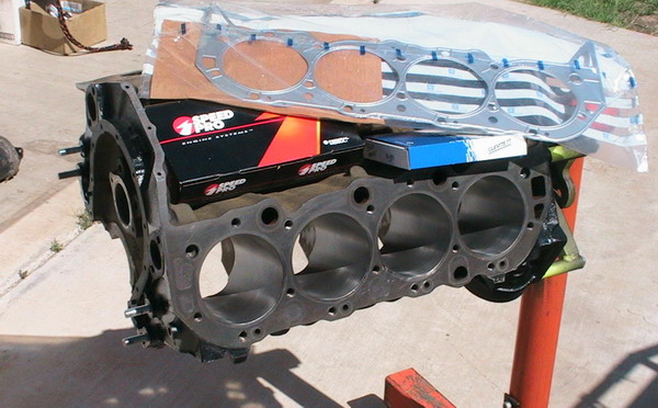

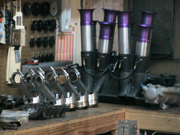

Well got the block back with a nice fresh hone and got er all washed and cleaned, and big Brown delivered my parts yesterday so I guess I can start putting it back together!.. I should get the rings fitted and the shortblock done today!. :good  :jumpie

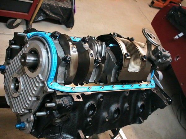

Well got everything cleaned up and the bottom end done!.Guess I'll throw the cam in and button her up!. :good
Post Icon Posted: Mar. 16 2005,6:54 am Post # 14 see this member send this member a private message  quote this post in reply

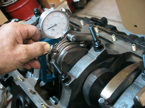

Cking rod bolt stretch :stupid I'm guessing. :confused
Post Icon Posted: Mar. 16 2005,8:14 am Post # 15 see this member send this member a private message  quote this post in reply
Good stuff.... :good   Thanks for taking the time to share the pix.... :beer
Post Icon Posted: Mar. 16 2005,11:01 am Post # 16 see this member send this member a private message  quote this post in reply
Quote (shueman @ Mar. 16 2005,9:14 am)
Thanks, I'll have more later!.. :good
Post Icon Posted: Mar. 16 2005,11:03 am Post # 17 see this member send this member a private message  quote this post in reply
Quote (AZKC @ Mar. 16 2005,7:54 am)
Yep, the only way to torque rod bolts!.. :)  :good

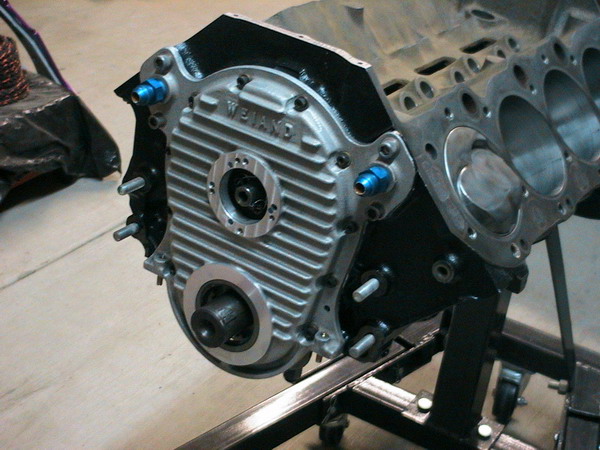

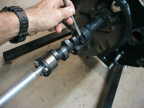

Well progressing right along, sure goes quick when all you have to do is put it back together :laugh  Here the bumpstick is going back in, after 13 yrs it still looks like new, not bad for a flat tappet!. :good
Post Icon Posted: Mar. 16 2005,7:26 pm Post # 19 see this member send this member a private message  quote this post in reply

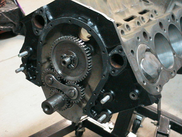

Gear drive is installed and since the cam has 2 degrees built in for chain stretch I set it at 0, that will give me 2 degrees advance which is where it runs the best!. :good
Post Icon Posted: Mar. 16 2005,7:28 pm Post # 20 see this member send this member a private message  quote this post in reply

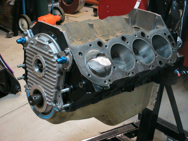

Timing cover installed and ready for water and injector pumps!. :good
Post Icon Posted: Mar. 16 2005,7:37 pm Post # 21 see this member send this member a private message  quote this post in reply
Ready for the oil pan, those one piece gaskets sure are the shit, you can use them over and over again and if the pan ends aren't beat up you don't need silicone and you can't over tighten them!.. :good  :good Next we'll inspect the heads!. :good
Post Icon Posted: Mar. 18 2005,4:50 am Post # 22 see this member send this member a private message  quote this post in reply

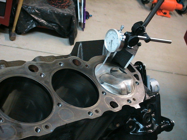

Oil pan's on, now it's time to clean the heads and check valve springs!. :good
Post Icon Posted: Mar. 18 2005,6:16 am Post # 23 see this member send this member a private message  quote this post in reply
BEAUTY...thanks for sharing, again...!!!  :good  :beer
Post Icon Posted: Mar. 18 2005,3:02 pm Post # 24 see this member send this member a private message  quote this post in reply
Gofast... what type of compression will that motor endup with... Ive never seen pistons that protrude that much!  Sweet motor :good
