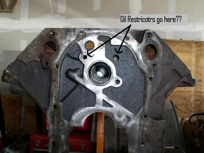

So the FE block is on the stand.  But first a question, where do the oil restrictors go??

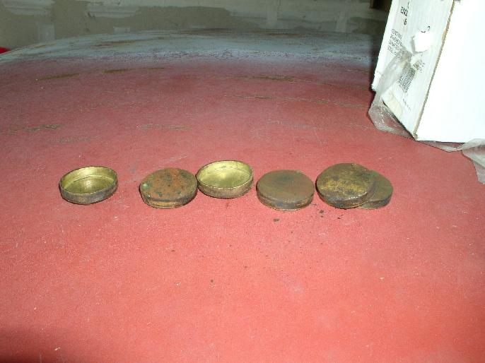

One thing that someone is going to get a call about is the freeze plugs.  They didn't get pulled when the block got cleaned so my water jacket is full of crap.  Every time I rolll the engine over, more crap falls out.
I punched them out, but I'm going to be giving someone a call on Monday to see what we can do about this.

First off, what restrictors??? :stupid  :stupid I see two oil galley plugs, one arrow points to a plug, the other one to one of the cam thrust plate bolt holes!.. Did you just put those core plugs in????? (I bet I know the answer to that)..
Now before you make an ass of yourself, :laugh  you were supposed to take those freeze plugs out, no machine shop will unless you want them to and they will charge you to do it. It's up to you to have it all ready for them, it should be stripped completely when you take it in along with all your measurements for machining!.. :)  :D
No, it came from the machine shop just like you see it.
That's my question... where do the restrictors go???   :stupid Everyone is telling me that I should install restrictors since I'm using a solid cam, but no one is pointing me where they need to go.  Or is it like I did on my Olds, and I need to install restricotors above the main bearings??
It's not a big deal about the freeze plugs... but it was put on the work order to intall new ones.  After I sat down and looked real close, I never was charged for them, so they will probably tell me tuff... I'll just have to spend more time cleaning is all...

That's what I thought, :( and I bet I see cam bearings in the block too huh???. Well if you want your bearings to last more than 5 minutes, you're going to have to strip it, pull all those core plugs(you're supposed to do that before you take it in) and knock out the cam bearings and clean the block. You need to run a brush thru all the oil galleys because they are full of shit, and garonteed there's shit behind the cam bearings, that's a normal automatic thing that you do when you get it back from a machine shop!..
Ok I gotcha, whoever you're talking to don't know what they're talking about. You don't put restrictors in, you block off the lifter passages and to do that, you pop the press plugs on the top galley and then drill and tap the inner holes for pipe plugs, actually you should do it to all the core plugs, those press deals do fall out occasionally=massive oil leak, :laugh You can put restrictors on the top end if you want but that's way down the line!..
They didn't put freeze plugs in because you didn't take the old ones out, but they should have called and asked if you wanted them to pull the old ones and put new ones in, they would have charged you for it too!.. :)

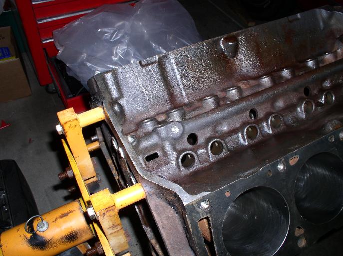

OK, the oil passages have threaded plugs in them, I'll go take a pic of it... stanby...
Here's the rear galley on the drivers side.  That plug is threaded.

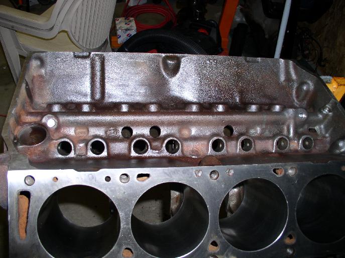

Post Icon Posted: April 03 2005,1:00 pm Post # 7 see this member send this member a private message  quote this post in reply
And now the passanger side.  The rear plug (on the right) is threaded, while the front one is pressed.

Hmmm, deceiving they looked like pressed in ones from the pic, anyhow they all should be tapped for pipe plugs. The off shoots at the rear of the block is where you install the plugs to block off the lifter galleys!.. :)
OK, that answers one question.  :good
I think my confusion came from hearing people say that I can restrict the oil to the lifters... I was hearing "install restrictors (like I did on the Olds)" not, "plug off the galleys"... you don't learn if you don't ask.. right?? :D
The only plugs that are threaded are on the off-shoots.  The others are all pressed.

Yep the only way to learn is to ask! :good Now take out those plugs and down inside you drill and tap for plugs, that's what blocks off the galleys!.. You don't restrict oil to the lifters, you restrict oil from going up into the valve covers, there's two different ways to do that but that's later down the road if you want to do that. Right now you need to take out every plug you can find and the cam bearings!. BTW, be careful taking the bearings out, if they come out hard you can reuse them!.. :good
