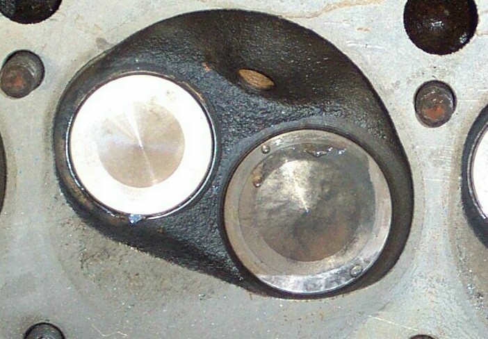

Interesting day yesterday to say the least :cool Sleek and Brother Drew came over and helped get the boat running and it sounded pretty good :good
But it only ran for 10 minutes and then something broke
If ya look close you can see #1 intake rocker is missing. It backed out while breaking in the cam. My bad there I'm guessin :beat
We pulled the plugs and had water in most of the cylinders and the #7 plug was smashed. So I knew what had happened. Broke another focking valve :banghead  :banghead
Its getting pathetic and a bit annoying. But it's only money :rolleyes
All the intake push rods are bent, all the pistons and intake valves have marks where they where smacking each other.
Really interesting pattern developing here and theories abound but no clear reason whats going on. Guess I'll be buying a motor from someone the next time or at least let somebody else build one out of my pieces. I surrender :drink  :D

From the pics it appears that all the intake valves have made contact with the pistons. Do the pistons all have marks on them? Got any pics of them?

Most all the valve reliefs have marks. But #7 definately has marks :eek  :laugh

Here's a cropped and expanded pic of the piston. You can clearly see where the intake valve has hit the piston at the left side of the "eyebrow".
I'd be looking at the things that could cause this in ALL cylinders....cam timing, too much lift for the parts combination, intake valves that are a larger diameter than the pistons were designed for.

This is a pic of one of the holes, all the intake valve were kissing the pistons. One just kissed a little to much.

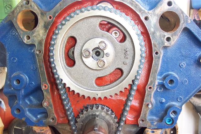

Actually its happened with 2 different blocks and 3 different sets of heads. Here's a pic of the timing stuff when I was putting it together.
This is a little different than before in as much as I said before the #1 rocker stud had backed out enough where the valve didn't open. We're going to ck the valve clearance just for piece of mind but I'm sure there is plenty. I keep leaning towards a hydro lock deal because of the #1 rocker issue and the amount of water in the cylinders when we pulled the plugs.

I do believe that pic identifies your problem. Your gears are not lined up correctly. The keyway is not what you line the cam gear "dot" up with. There should be a "dot" on the crank gear. If you cant see it, you probably have that gear on backwards. When the dots are lined up on the two gears, the keyshould be pointing in line with the #1 cylinder .
Your cam looks to be about two teeth advanced.

Thats a Comp Cam timing gear there are three keyways with three marks A....O....R its lined up with the 0 which is 4* advanced according to the MFG. I've thought about using the R mark which is 4* retarded. I've read that retarding the cam timing will give you a little more intake valve clearance but you lose a little exhaust clearance. We degreed the cam and it seemed right on, wouldn't have improper gear instalation showed up then :stupid

When you use that crank gear, you have to match the keyway in the gear to the dot on the gear. That is, if you use the "O" dot you must also use the "O" keyway. If you use the "A" mark on the gear, the "A" keyway must be used.
Any choice you go with, when the gear marks are lined up, the keyway WILL line up #1 cylinder.

What do you mean the keyway will line up with #1 :stupid
Post Icon Posted: May 02 2005,11:14 am Post # 25 see this member send this member a private message  quote this post in reply
Quote (Oldsquirt @ May 02 2005,11:03 am)
I didn't see any dots on the cam gear just the letters and they are above the keyways. Your theory makes alot of sence. Cause the timing set is the only thing used on all motors that failed. Only catch is the first motor I killed using this set up lasted 15-20 hours till it kicked a rod. And I pretty sure I had the cam gears installed just like that.
