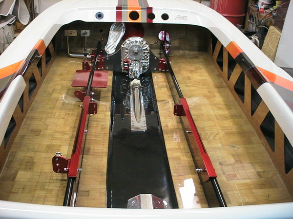

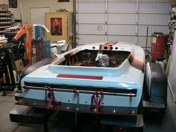

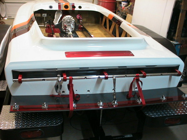

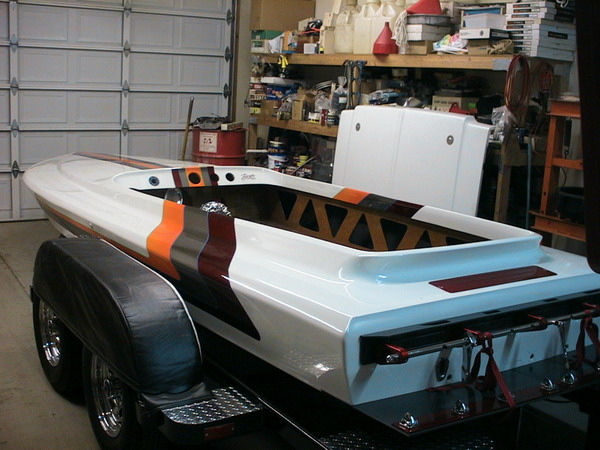

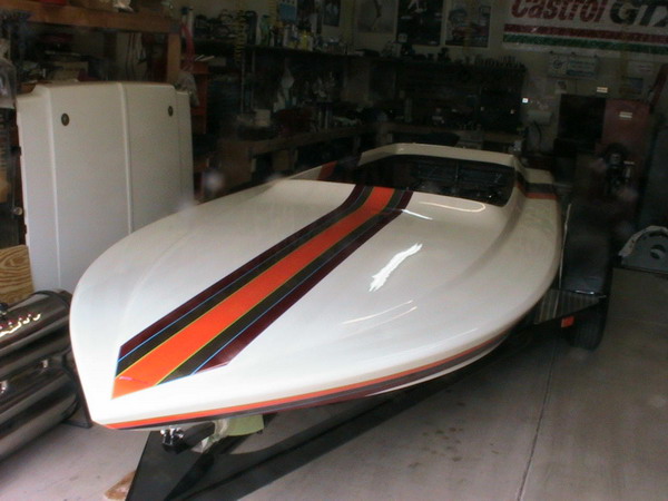

Well got me some work to do, gotta line up the motor for a solid driveline, make some motor plates, mount the stack tanks and mount the battery box, for now anyways!..This will be a K boat with an injected PSI blown motor!.. :good  :jumpie

Fockin A  :jumpie Is it a new or restore? Somebody from PHX area? What kind of hull? Details man details :beat  :D

Post Icon Posted: May 06 2005,7:37 pm Post # 10 see this member send this member a private message  quote this post in reply
That thing is SWEET...!!!   :good  :beer   That the one ya brought back from Upland (909).... :confused

That's the one I went and picked up at Billy B's place a few of weeks ago, it is the narrow Biesemeyer(Bezer). It was a total POS last year, it was the blue one he had, it was posted on HB!. A friend of mine(sgd7) bought it, going to make a K Boat out of it, going to join the NKRA, have a notion to do the same thing when the Rayson gets done!.. :good  :jumpie

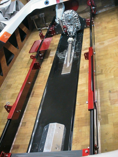

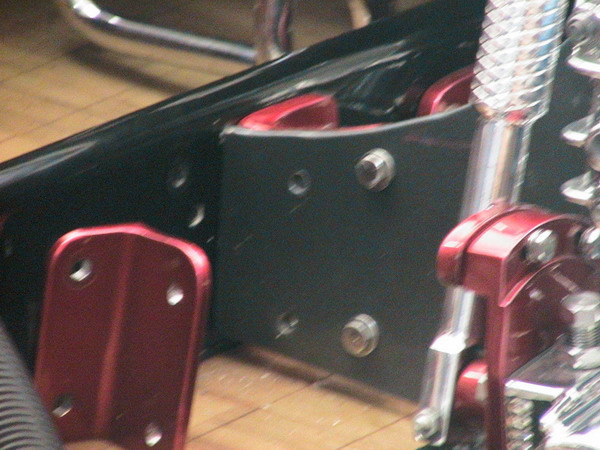

Since the v-drive was already mounted for me I didn't have to mess with it right, yeah well something in the back of my head kept telling me I'd better stick the prop shaft in and see it fits, good thing I did because you couldn't slide the coupler but a 1/4" on the shaft, it was a no go. Now if I'd lined up the motor for the driveline and made up the plates and brackets and bolted it all in and the prop shaft wouldn't go, man what a mess that wouldv'e been!.. :eek  That's what happens when you powder coat everythng and don't tape off all the contact sufaces, also when the stringers were all redone material is added so that changes too. The thing to do would have been not to powdercoat anything and plug up all the holes in the stringers and start from scratch, that way you just line the v-drive up, clamp it, drill and bolt it up done deal!.. So the easy way would have been to just line up the box and make new brackets, but since they are all nice and pretty I decided to try and save them which I was able to do, it took me just about six hours to do it but I finally did it, the coupler slides on just as smoothe as can be!.. :good  That's cool, more $$$$$$$ for me!.. :D  :good
Post Icon Posted: May 10 2005,8:21 pm Post # 15 see this member send this member a private message  quote this post in reply
Now that that's all fixed, next will be to line up the motor and make new plates and brackets, again I have to work around holes already there and try to make it look right, damn why didn't they just plug everything up and start from scratch, Oh well, more hours more $$$$$$ :good Just a pain in the ass!.. :laugh

Well its progress :good  it seems building from scratch is a simpler way to do things than figure out some other persons puzzle :break  :D

Man you got that right, it's a real pain in the ass to try and match things up and make it right, :(  it's a lot easier to start from scratch, just measure drill and bolt it!. :good

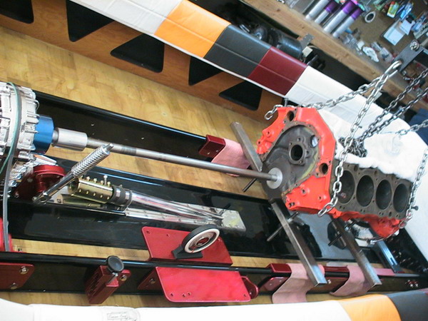

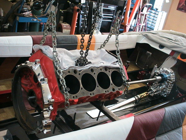

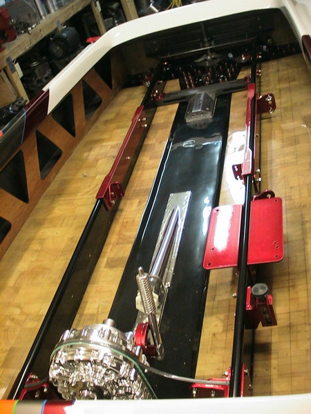

Well back to the project, it's time to line up the motor for the solid driveline, the jig is in the block and I hang it with the hoist and get it as close as I can and set it down on the rails!..
Post Icon Posted: May 11 2005,8:16 pm Post # 25 see this member send this member a private message  quote this post in reply
Block is in the right position, 34" from the transom and the shaft and dummy coupler are close!. :good
