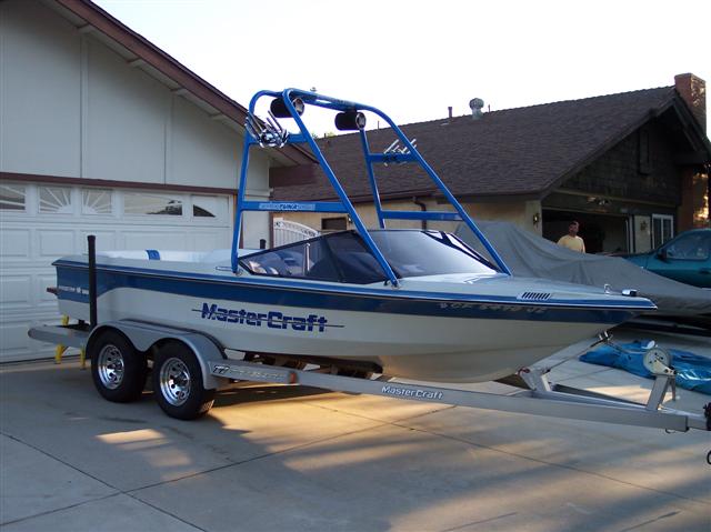

We're going to look at a Mastercraft 190 Standard this week-end.  Boat looks clean, from the street.  It's 19' with a 350 w/direct drive, fat sacs, wake tower, new interior, etc.  Owner says it has 560 hours on the orig motor.
Price seems right at $12k OBO.  Any advice on "watchouts", what to look for, etc..??  I am going to ask for a test run....'

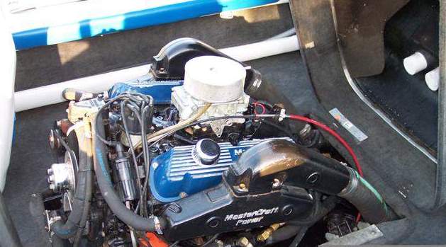

Boat Trader engine pic

Looks really clean could be a good deal, :good But you never know, need to look beyond the cosmetics. Have him pop the sub floor and take a look down there for cracks and the hardware, check the shaftlog where the propshaft comes up for signs of leakage and look at the rudder, move it around it shouldn't have any slop in it, also the seal in the stuffing box. Check the steering at the rudder, make sure it's all nice and tight!.. Motor looks clean but check all the plumbing, if it needs to be replaced it's something to consider in the price. Pull the dipstick and see what the oil looks like, if he just changed it take a breather cap off and look inside the valve cover, it should be nice and clean!.. If all checks out take it for test drive and run it hard and see what the motor sounds like, when you come down to an idle it should run smoothe and quiet!.. :good
BTW, what kind of boat is under that cover next to it!.. :stupid  :)

Thanks Art.... :beer   We're goin' down to see it PM today.
The other boat had Centurion on the side...looked low-profile when we drove by on Sat....rear tower under that cover...??

Looks like it's well cared for and even the trailer looks great in the pic. :good I hope it turns out well for you. :beer

Well the 19' Prostar turned out to be a BEAUTY......very well cared for....they guy liked our attn. to the mech. details.....thanks again Art for the watch-outs.
The 351 was is great shape and had all the maint. records, bottom was clean, gelcoat was a lil faded is all...It's for my bro-in-law; paint would have been no prob, turns out he went to HS w/Billy B... :good
It's a pure ski boat for sure...no storage anywhere..!!  The guy got an offer for $11.5 and called us with first dibs...bro said....NOPE.... :rolleyes
