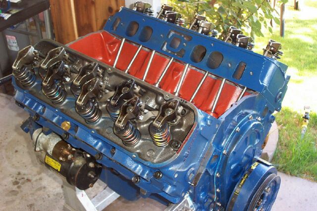

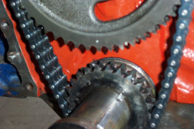

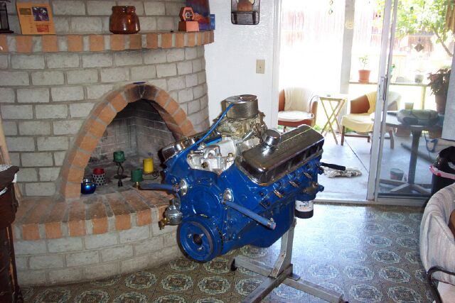

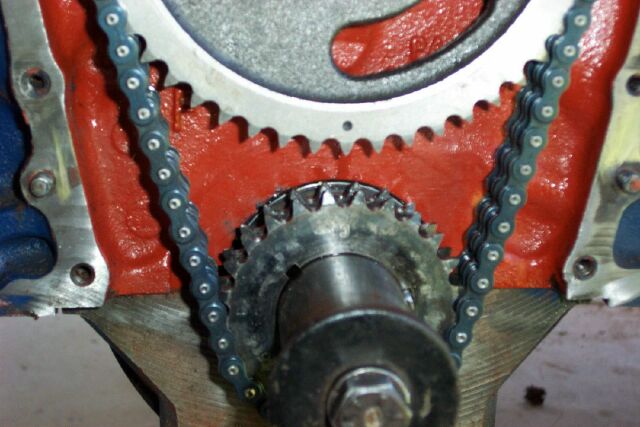

Well things kinda fell together and I put this biatch together yesterday :good Went pretty smooth, and after double cking the timing marks 4 times. I noticed it was on wrong again :beat I tell you the 0 mark on the crank gear is barely visable. And there are other marks to confuse you even more. This is a pic of it on wrong :flamed

Post Icon Posted: June 05 2005,8:31 am Post # 2 see this member send this member a private message  quote this post in reply

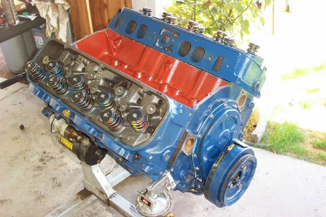

This is with it correct, also learned that the pin on the  camshaft is at 3 oclock when the marks are lined up right(6 oclock and 12 oclock)

Slap the pan and heads on :good

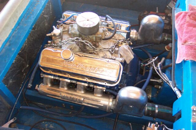

Next is the valve train :beer Another thing I've learned is run the valves before you put on the intake. Its easier to find zero lash by spin the push rods in the block than trying to grab them under the rockers. :D
Post Icon Posted: June 05 2005,8:37 am Post # 5 see this member send this member a private message  quote this post in reply

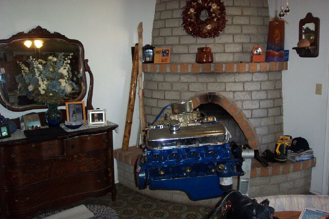

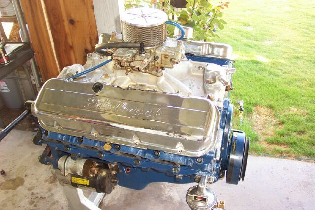

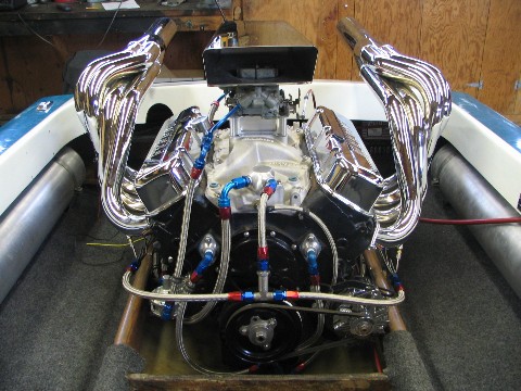

Next up intake and valve covers. Need to drag this beast thru the kitchen out to the boat(Becky loves this part :fight ) and get this thing to the water next weekend.

Well like I said, time to put this turd together, first a quick trip thru the kitchen :rotflmao
Post Icon Posted: June 05 2005,4:40 pm Post # 9 see this member send this member a private message  quote this post in reply
Try this across your your tile floor :D
Post Icon Posted: June 05 2005,4:42 pm Post # 10 see this member send this member a private message  quote this post in reply

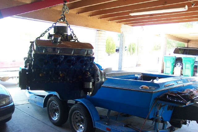

Oh yeah and just a little FYI, leaving the mounts on the stringer is not good :break took about 2 hours just to get the motor bolted in :fight  :D
Post Icon Posted: June 05 2005,4:49 pm Post # 12 see this member send this member a private message  quote this post in reply
Looks like a lake trip coming up this weekend :beer . Try and get the cam broke in by Tuesday and finish things up by Friday. With a day trip to Apache on Saturday :drink

Its a running boat again. :beer  Fired it off last night for about 10 seconds, tonight I'll get the cam broke in and set the timing. Takin tomorrow off to button it up :drink  and looks like a trip to the lake is in order don't know which lake or for how long yet :stupid We'll decide that tonight.
