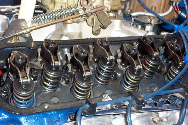

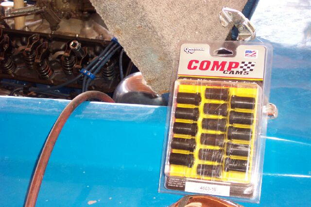

Well since my rocker arm nuts gave up the ghost and wouldn't hold adjustment on about 4-6 valves. Time for an upgrade.
Post Icon Posted: July 02 2005,1:30 pm Post # 2 see this member send this member a private message  quote this post in reply
Slap them babies on, reset the valves and we're back in business :good Now all thats left from the river trip is fixing the seats that got busted up on the Parker Ocean :(

Post Icon Posted: July 03 2005,6:25 am Post # 6 see this member send this member a private message  quote this post in reply
Quote (AZKC @ July 02 2005,1:30 pm)
Looks good :good Did you make sure the studs have a flat surface??, usually factory ones aren't flat and the damn set screw won't hold, normal procedure is to grind them flat, I just get aftermarket ones screw it!.. :D  :good

Seats are in OK shape I'm having problems keeping them bolted to the floor. I'm going to look for some sort of toggle or molly bolt setup. The bolts keep pulling out of the floor, probably just my fat ass is to much for them :laugh
Post Icon Posted: July 03 2005,8:29 am Post # 9 see this member send this member a private message  quote this post in reply
Quote (GoFastRacer @ July 03 2005,6:25 am)
These are ARP rocker studs, got it fired yesterday.  :good Changed the fuel filter it was about 50% restricted. I'm going to put a fuel/water seperator on it. Saw one on Overtons fro about 30 bucks with a spin on filter. Should do the trick.
