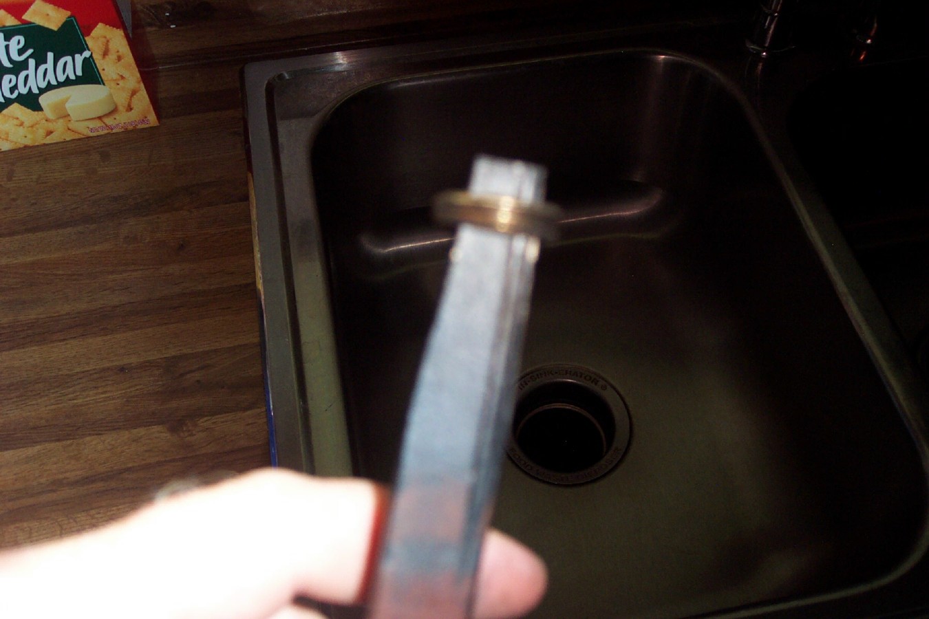

So the broken piece of the fitting is out, no wonder it broke it was only in about 1/8 of an inch :break The guy at Panther recomended running a tap thru it to clean the threads. So I did that and it went ok I guess. But when I thread a piece of 1/2 pipe in to it, it only wants to go in about 1/4 inch.
Are pipe threads tapered? If I run the tap thru the hole all the way through the hole(its about 1 inch thick) does that mess up the sealing characteristics of the pipe thread. Also should the tap be able to go all the way thru, it gets real tight towards the top of the tap. The bottom of the tap sticks out of the hole about 3/4".
Heres a pick of the 3 threads that were in the pump. :(
