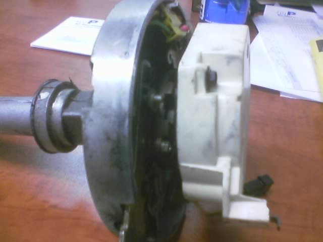

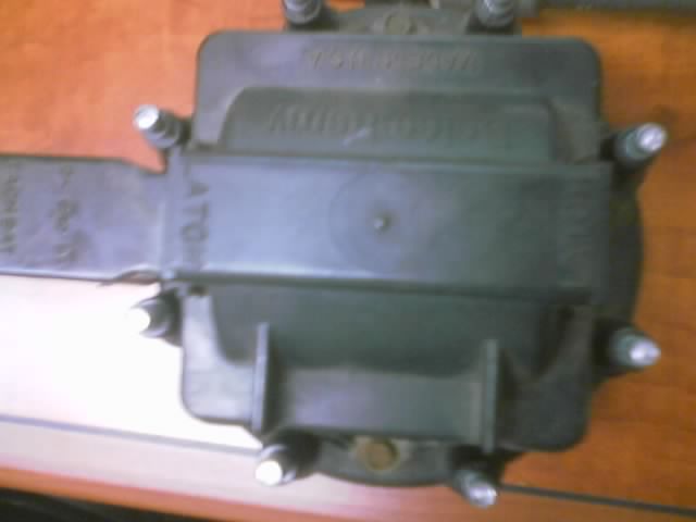

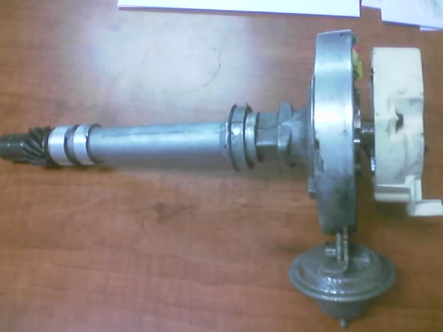

Hey I have a complete GM HEI With a performance Coil for sale if you want it.  $60.  It was on my old grenaded engine...

Hey what coil and Module you have in it??, standard or tall deck???, I'm interested!.. :good

:confused I would llike to tell you but I have no Idea...  On second look It just looks like a standard HEI...  But here are the pics... Tell me what measuremnts you need and I will take them...
Post Icon Posted: Aug. 04 2005,8:32 am Post # 14 see this member send this member a private message  quote this post in reply
:drink I think the vaccum advance has been locked out.

This was on the Old Grenaded ZZ502, I think it came with the crate motor?  Either way just let me know.   I was just keeping it for a spare in case the MSD took a crap...
Post Icon Posted: Aug. 04 2005,8:33 pm Post # 17 see this member send this member a private message  quote this post in reply
Looks like a bone stocker and if it came with the crate deal it is, well crap that's a little high think I'll pass thanks anyhow!. :good  Probably a good idea to keep it with you on the boat though with that MSD junk, could be a life saver one day!. :D  :good
