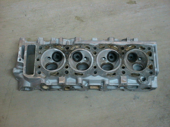

Well shit tanked the head over the weekend and found the ploblem, notice the back chamber color looks different!.. :(
Post Icon Posted: Sep. 06 2005,8:56 pm Post # 25 see this member send this member a private message  quote this post in reply
Here's the problem, notice the corrosion right where the sealing ring of the head gasket goes, that's where the water was going in, I was wondering why that piston looked kinda rusty!..
