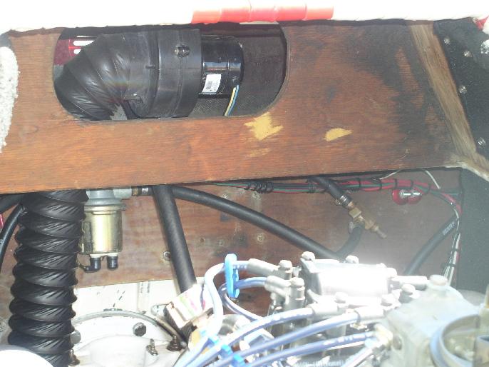

OK, so we had a little problem with fuel getting to the engine last time out.
A little plubing project was born, to try to keep the same situation from happening again.
Here what it looked like before we started.  Andrew had already pulled the filter off, it was just to the right of the pump, but was mounted with wood srews to the transom and just about fell off in his hands.  Something different would have to be done.  I was thinking about mounting everything off a fabricated bracket mounted to the swim step hardware poking through the transom, but decided against it.
You can also see the old T fitting tied up to the wiring harness, we tried to just plumg the left hand tank to the pump, but the boat still wouldn't start.  We found out why, but that will have to wait. :D

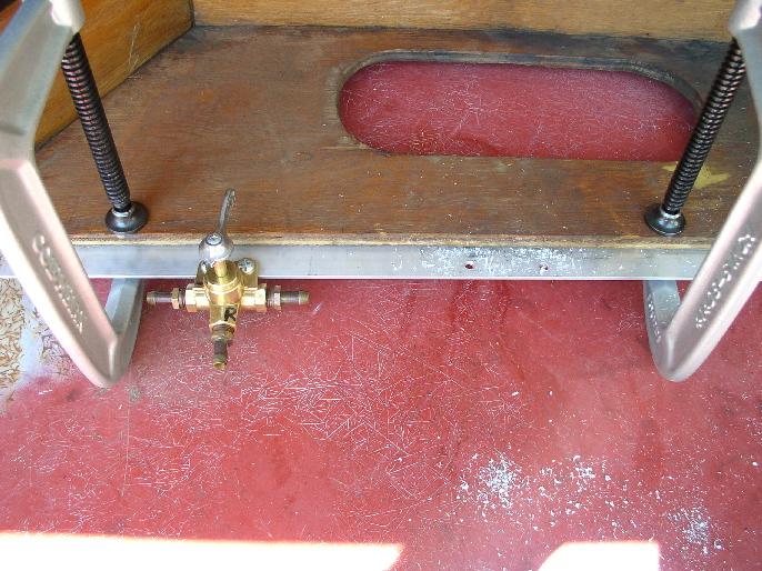

OK, so where to mount everything??? I needed to mount the new fuel selector and the fuel filter.  After looking at it a while, I decided to use some aluminium strap along the small bulkhead on the rear piece of the dog house.  Off to Lowe's I went and came back with some aluminium, hardware, and what I hoped was a pretty good plan.
Here's what it looked like about half way through mounting everything up.  The selector is mounted, and I'd just got done drilling the holes for the filter.

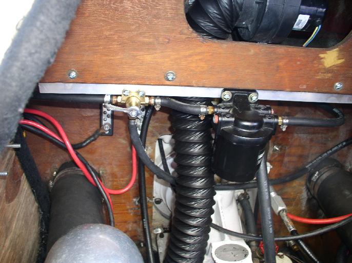

Post Icon Posted: Sep. 18 2005,9:05 am Post # 3 see this member send this member a private message  quote this post in reply
All the holes drilled and the bracket mounted to the dog house, it's time to re-mount the rear dog house and see what it looks like.
I should have put one more fastener right in the middle, just to balance things out.  Symetry you know.  :D

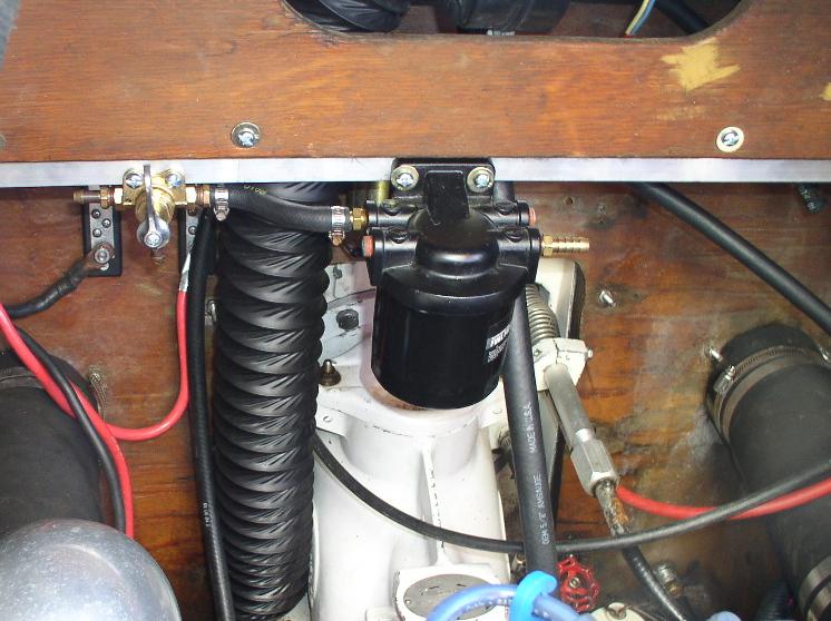

Post Icon Posted: Sep. 18 2005,9:10 am Post # 4 see this member send this member a private message  quote this post in reply
And all done and plumbed up.  The filter is clogged, since I can't get any fuel through it, but I should be able to remedy that rather quickly.  I'm headed out this morning to tie everything up and make it look all neat and shit.  :D
Oh, and about the carb.  We knew we were getting fuel to the carb, but the damn boat still wouldn't start.   :beat Off came the carb and I tore it apart.  Water water everywhere.  Must have sucked a bunch of H20 off the bottom of the tank when we ran it "dry".  Motors don't run well on that stuff.  :D Probably the reason whey the filter is all clogged up as well.

To bad it doesn't work...  :laugh
I've been fidelling with this all morning, but I can't keep the system primed.   :beat What's odd is that all the components are at the same height as they were before.
I think a couple check valves at the tanks would cure it, maybe.  I just need to find a couple.
