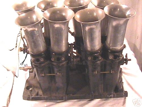

Hey GFR,
please check this out.. And tell tell me what you think!
Injection
Can you tell me the pros and cons for injection?

Thinking about putting injection on your jet? How much of hp bump would you get out of that?
Post Icon Posted: Mar. 14 2006,5:06 am Post # 10 see this member send this member a private message  quote this post in reply
Quote (Tuchop @ Mar. 11 2006,8:52 am)
All depends on what's on it now, but the best part of injectors is the simplicity and reliability, not to mention throttle response, once set forget about them!.. :good

What are you looking to get into, mechanical or EFI??, either way you wouldn't be sorry!. But if you're not familiar at all on how mechanical works, and if you're not interested in learning about it(it is very simple)you might be better off to go EFI, but either way once setup you can forget about them unless there's a drastic change in weather or altitude!.. If you can get it cheap enough, this could be a good start for an EFI deal!.. :good

I was looking for mechanical fuel injection...  But you are more of an expert than I am!
I have a BG Anular 850 Mighty Demon on a victor intake...
What appreciable gains would i see?
Throttle responce?
Gas mileage?
Cool Trumpets on top?

No problem with mechanical just need to learn how to tune them, and they are very simple once you learn how it all works!..
To compare injectors to a carb is night and day, no comparison at all!.. Throttle response is like a light switch, also there's no floats so it don't matter what the conditions are they will always be crisp, no sloshing of fuel!.
Gas mileage is hard to tell a lot depends on driving habits, you can ad a jet selector so you can lean it a bit while cruising, I've never used one myself and I can cruise at 2500 all day long, but I'm sure it would help, I did gain some mileage over my tunnelram though, cruising and WOT!..  :good
