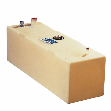

I know.. It never ends with me and boat projects...  But hear me out...
Loaded down with people it takes me one tank (out of two total) of fuel to get from Needles Marina to Havasu, give or take a 1/4 tank...  And I hate filling up on the water..
So I was thinking, since I have a tons of room on either side of my engine, and the water jacketed manifolds keep it very cool in there, I would add two extra tanks to the boat for those trips where we are traveling from needles, to the dam...
Has anyone ever done this?  Am I going to blow my ass up?
What do ya think???

Make sure they are vented outside the engine compartment and I would use a bulkhead or enclosure around the tanks for extra protection. My .02.

Is there enough room to just replace your tanks with bigger ones?? I'm thinking about the extra wiring and plumbing that is going to be needed to just add tanks. (filler necks,vents, feed lines, guages, flow valves...)

I would not recommend that at all, mainly because of all the plumbing and electrical to connect them all in and extra vents, also the weight is a factor in handling, not to mention bringing the value down some!. Myself I would just have new ones duplicated with more capacity and keep it simple and sanitary, and "safe"!.. :good
