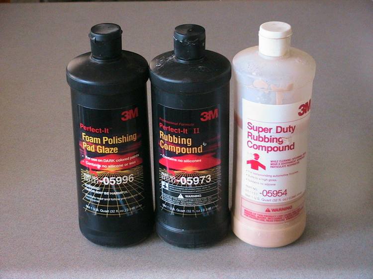

Well this is no way my field so I won't begin to suggest anything, but the wife used this 3 step deal on the Daytona and man it came out looking like brand new, and it's 20yrs old!.. :good

Quote (GoFastRacer @ Aug. 06 2006,8:18 pm)
I've been using that shit on the right for years.
Good stuff! :good

Quote (Bullitt Bob @ Aug. 06 2006,9:34 pm)
Good stuff! :good
And easy to use!.. :good

Foam Pad Glaze!! :good  That's some good stuff there!!  :good  :D
Post Icon Posted: Aug. 08 2006,6:04 am Post # 16 see this member send this member a private message  quote this post in reply
Really brings out the shine!. :good

I beg to differ here, if you use the right compound it works, like the 3M stuff(posted above)if you use a compound for paint it is not as agressive and it won't do the job on gel.

WTF Steve.  3M 05973 Rubbing Compund is the only thing I use on the Hallett.  Dude, you must be using the wrong shit.  Bring your boat by Hallett Dave Headquarters some weekend and let's see what we can do for the Eliminator.
