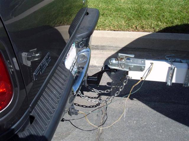

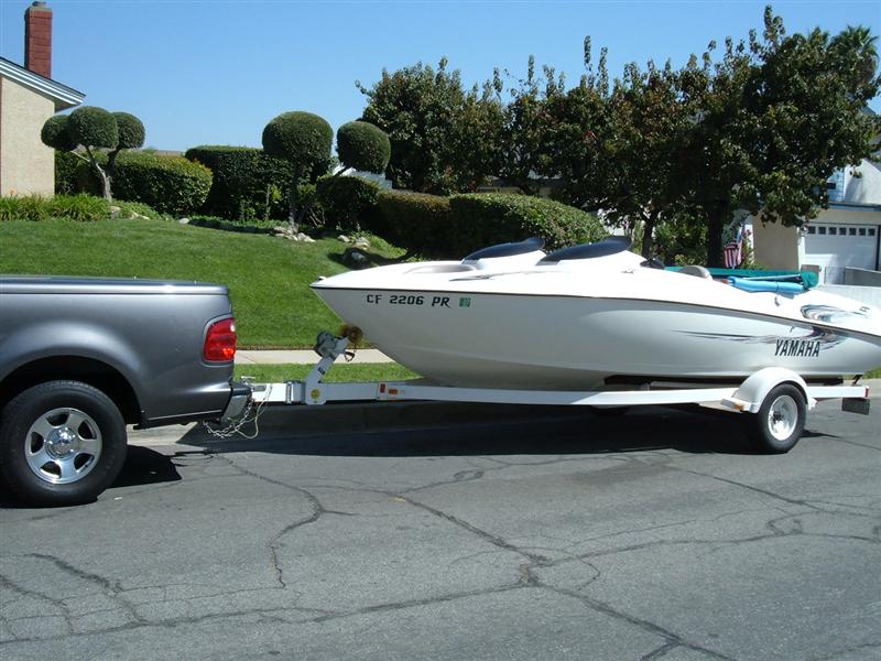

OK....I have 2 trailer hitches, a 1" and a 2.5".  With my other boat & waverunner trailers, these drop-downs were needed.
With the POS Yami, I had to flip over the 1" to a "drop-up" and have had no problems, other than the trailer still tows at a slight down angle.
I've turned over the 2.5" and will test it today.  The way the ball mount is designed, a slight downward angle, the ball now will have a slight upward angle.
Should I be OK with flipping over the 2.5"..??  Boat & trailer around probably 3,000 lbs total.  I'm thinking if it gets a good bite on the ball, all should be fine; just don't know all the physics involved in having the tow-point that far above the receiver.
Wa Da Ya Cey.... :stupid

I have had to do that on a few occasions. Never had a prob.
As long as you don't exceed the rated tongue wt. and torque the ball after you flip it, I think you'll be fine with your Yammie. ;)

Thanks bud.....it seems to be fine, just enuf to flatten out the trailer angle through the axles....trails a little lower in the  back is all....

The ball mount is actually near parallel with the ground.... :cool   A few cases of 12z in the bed for traction and I'm good to go... :D

The flatter the trailer the better, but I prefer mine to be just a touch down that up. My thought is when stopping, the weight will transfer to the truck in the downward  direction. I would think that if the trailer is up, it would want to take the weight off of the truck?? Just my way of thinking......

I think that looks OK Shue. You are almost right where you'd be if the ball were on the step bumper. ;)
That'll help you clear those agro driveway dips. :good

Your right on the downward angle....keeps the boat resting nicely against the bow stop.... :good
There are times when retrieving, like on a steep ramp like Jack Smith, the boat will slide back a few inches.  With the slight downward angle, a few traffic stops and road bounces scoots it right back up... :cool
I'll just bring 'em both next week-end.... ;)
