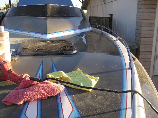

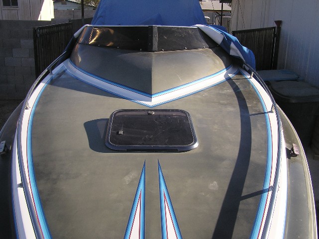

Here's What I Started With....
Post Icon Posted: Oct. 14 2007,4:53 pm Post # 13 see this member send this member a private message  quote this post in reply
Post Icon Posted: Oct. 14 2007,4:54 pm Post # 14 see this member send this member a private message  quote this post in reply

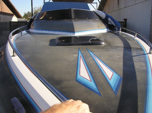

Lightly sanded with 1500 and soapy water....
Post Icon Posted: Oct. 14 2007,4:55 pm Post # 15 see this member send this member a private message  quote this post in reply

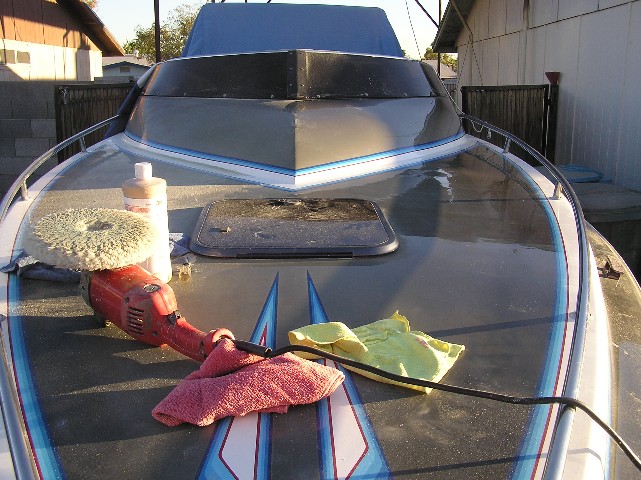

Lightly Buffed With 3M Heavy Compound And A Wool Pad....

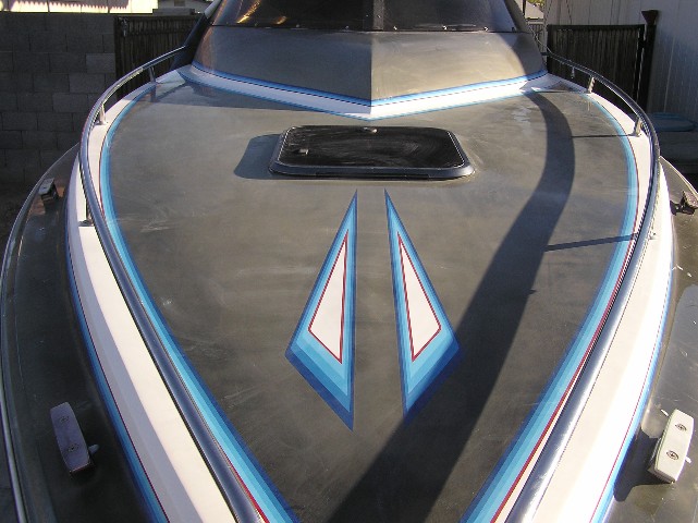

Post Icon Posted: Oct. 14 2007,4:56 pm Post # 16 see this member send this member a private message  quote this post in reply
I Need To Get A Foam Pad And Some Finishing Compound...But This Is Where I've Stopped For Now....

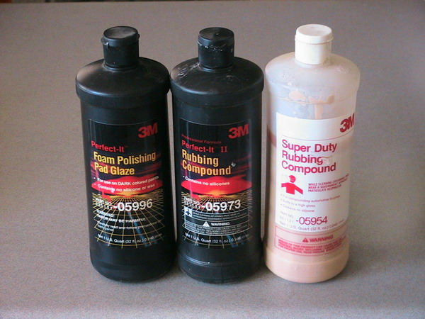

Post Icon Posted: Oct. 14 2007,8:31 pm Post # 17 see this member send this member a private message  quote this post in reply
Looking good :good Is this what you used??, made my Daytona look like brand new!.. :good
Post Icon Posted: Oct. 14 2007,8:34 pm Post # 18 see this member send this member a private message  quote this post in reply
That's the compound, but I just finish wiith Finessit II and a foam pad....
Post Icon Posted: Oct. 14 2007,8:47 pm Post # 19 see this member send this member a private message  quote this post in reply
That's better than the Pad Glaze??.. :stupid
Post Icon Posted: Oct. 14 2007,8:53 pm Post # 20 see this member send this member a private message  quote this post in reply
Never tried Pad Glaze...
Post Icon Posted: Oct. 14 2007,9:53 pm Post # 21 see this member send this member a private message  quote this post in reply
Don't know much about detailing, all I know is that 3 part deal worked great and the Pad Glaze really brought the shine out!.. :good Of course I've never used anything else so I can't compare!.. :stupid
