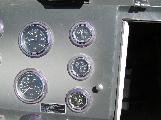

My little 6.2 has always ran at 160. On long stregthes at WOT it would creep up to 165. Had new impeller put in. Now just cruising at 3000-3200, temp goes up and down from 140 to 175. Going thru thompson at 600 temp varies from 135 to 175.
Anybody got an idea what's up?

most mercrusier engines usually run at 160 to 175 depending on what temp thermostat they have installed
ive even seen them cycle from 135 to 180 but they all vary a little depending on the gauge and sender to

I've seen engines run in a range, but never that big a range....
Is there a chance they used the wrong impeller? It sounds like an impeller issue, or a crap thermostat...
