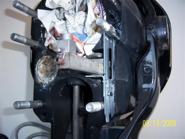

OK Folks, I made a tool tonight to hold the shifter slide in place. Took me 10 minutes and I had the 2 pieces on hand. I will have pic's of it this weekend. Once I post the "Tool" I can't wait to see who can come up with what I used as the main part of this tool.  :D

Here it is. The Slide Guide.  :D   :good   :laugh

OK my guess is your slide guide is a guide from a Skill saw or a Jig saw :stupid

Post Icon Posted: Mar. 13 2009,11:04 pm Post # 35 see this member send this member a private message  quote this post in reply
kinda looks like this POS bracket I bought at Home Depot to mount a ceeling fan... It didn't work for the fan so it is probably in a box with a bunch of other useless crap at the shop :beat

:rotflmao  your not even close!!   :laugh

I know what it is got a bunch of em, don't want to spill the beans yet though!..  :D
Post Icon Posted: Mar. 14 2009,8:17 am Post # 38 see this member send this member a private message  quote this post in reply
Not even a clue. :stupid
Posts: 63,339
Post Icon Posted: Mar. 14 2009,8:56 am Post # 39 see this member send this member a private message  quote this post in reply
Quote (WATERDOG @ Mar. 14 2009,8:17 am)
It's a cover, that's all I can tell ya or else I'd give it away!.. :D
Post Icon Posted: Mar. 14 2009,9:40 am Post # 40 see this member send this member a private message  quote this post in reply
Quote (GoFastRacer @ Mar. 14 2009,8:56 am)
To good of a clue, dead give away. I've got a couple around here too.

Post Icon Posted: Mar. 14 2009,8:23 pm Post # 41 see this member send this member a private message  quote this post in reply
Quote (WATERDOG @ Mar. 14 2009,9:40 am)
:laugh   :good   Lets see if anyone els pic's up on it. I have acces to quite a few and thought I would give it a try. Wiat till you see what ells I did.  :D

Post Icon Posted: Mar. 15 2009,8:09 am Post # 44 see this member send this member a private message  quote this post in reply
Looks Like A Plate Off Of A Computer With An "L" Bracket Pop-Riveted Onto It.....
Posts: 63,339
Post Icon Posted: Mar. 15 2009,8:56 pm Post # 45 see this member send this member a private message  quote this post in reply
Yep, a PCI slot case cover, got a whole bunch of them!.. :D
Posts: 25,793
Post Icon Posted: Mar. 15 2009,10:46 pm Post # 46 see this member send this member a private message  quote this post in reply
:good  That would be the part! I had several at work that are flat that worked out great for holding the slide.  As CE found, I did rivit an "L" bracket I had to it. If I need to I can twist tie or zip tie the bottom part to the bottom stud to help hold the slid level.  :good

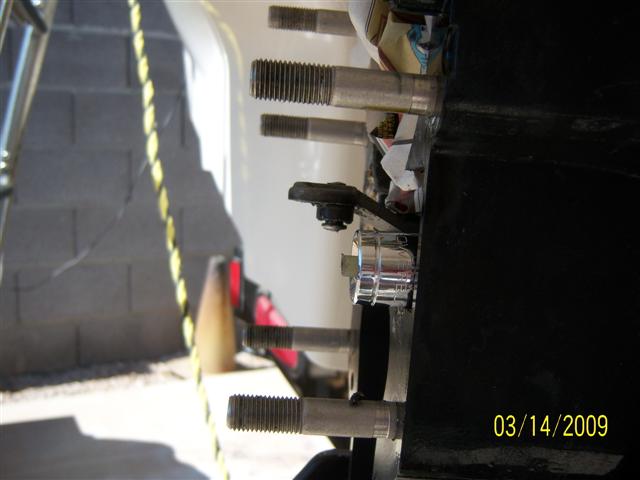

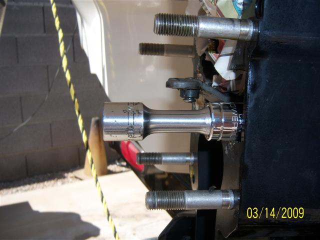

I went and bought a 9/16, 1/2 drive socket that fit the cable nut dead on. But the nylon inner core of the cable housing was longer that the socket.

To fix the issue of getting a rachet on the socket I adjusted an extension. I had 2 extensions the same length. So I drilled out the end of one. A little over kill was I drilled past the lock ball. I ended up removing the lock ball and drilling past it. I guess I drilled about an inch into the extension total. Once the drilling and cleaning of shrapmetel. It was ready to use.

Post Icon Posted: Mar. 16 2009,5:55 am Post # 50 see this member send this member a private message  quote this post in reply
Quote (BigDog @ Mar. 15 2009,11:01 pm)
Pretty cool  :good could have taken a deep socket and turned it down some couldn't ya?, would have saved a bunch of time messing with an extension, I would think!.  :stupid
