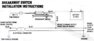

diagram :D
26304.  (a) Power brakes on any trailer or semitrailer manufactured
after December 31, 1955, operated over public highways and required
to be equipped with brakes shall be designed to be automatically
applied upon breakaway from the towing vehicle and shall be capable
of stopping and holding such vehicle stationary for not less than 15
minutes.
per Ca VEHICLE CODE

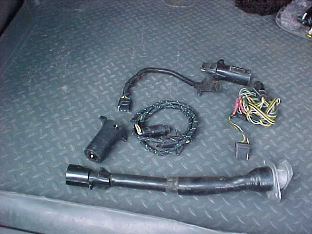

This it what I carry In my excursion.

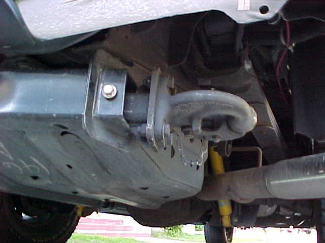

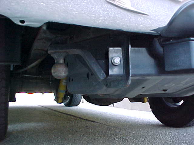

Hitches under the truck :good
Post Icon Posted: Feb. 08 2006,9:59 am Post # 111 see this member send this member a private message  quote this post in reply
one more

Quote (stingray @ Feb. 08 2006,10:58 am)
Cool setup!.. :good
Post Icon Posted: Feb. 09 2006,8:14 am Post # 116 see this member send this member a private message  quote this post in reply
Works ok, I've done something like it on most trucks I own, that way the hitches stay with the truck and are not rolling around in the bed or stuck out of the hitch to trip over.  :good

Quote (stingray @ Feb. 09 2006,9:14 am)
Yeah I hear that, them hitches sticking out are just the right height to catch the shins, man does that hurt, LOL.. :laugh And when you put them in the bed, for some reason they always end up at the front, wonder why!.. :laugh
