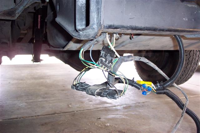

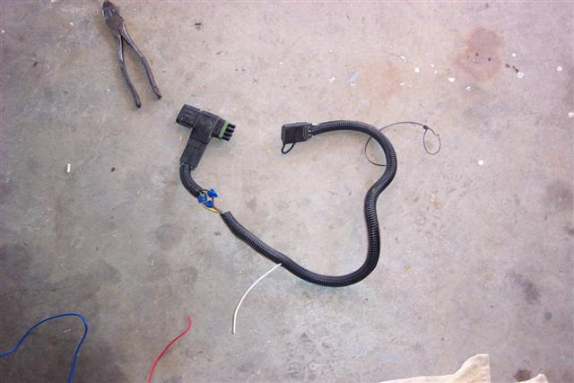

So it was "Whats wrong with the backup lights weekend"
Ran through some trouble shooting and thought the switch on the column was bad. BUt when I took it out I noticed it was installed wrong. So ck the switch manually and it sending power to the lights but they no worky. Ck the rear no power at the lights, ck at the fire wall, got power,ck down the frame, got power. Ck at the adapter got power going in nothing coming out :stupid
APPD 1.89
Post Icon Posted: Feb. 26 2006,12:27 pm Post # 133 see this member send this member a private message  quote this post in reply
Start digging around and find this here pigtail that Sleekjet said should be there :good But its got no power to any of the circuits :banghead
APPD 1.89
Post Icon Posted: Feb. 26 2006,12:28 pm Post # 134 see this member send this member a private message  quote this post in reply
After about an hour of chasing wires and swapping plugs about 15 times. I took the adapter out :break
APPD 1.89
Post Icon Posted: Feb. 26 2006,12:32 pm Post # 135 see this member send this member a private message  quote this post in reply
Then plugged the stuff together and presto everything lights up and got power to the factory pigtail. But now I have to rewire the trailer plug cause it unhooked. Got that done and even have a backup light circuit for my trailer now.  :good
