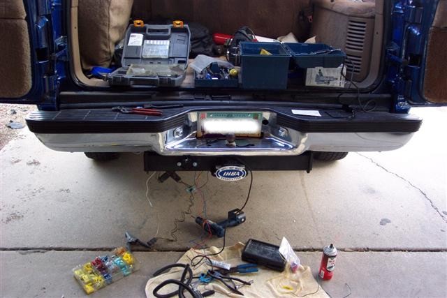

Post Icon Posted: Feb. 07 2006,7:00 am Post # 98 see this member send this member a private message  quote this post in reply
Well I've been slacking a little on the project but decided if I'm going to tow the boat. I'd better get the lights hooked up :)
APPD 1.89
Post Icon Posted: Feb. 07 2006,7:09 am Post # 99 see this member send this member a private message  quote this post in reply
So it had one of the adapter kits on it for a clean install but it was for the flat 4 pin connector, and the ground was a joke. I wanted to keep the 4 pin for any other trailer I may tow but the Blue Canoe trailer is set up with the round 6 pin. So I just T-Tapped into the harness and it was a done deal. While I was in there I took apart the old connections to clean them up and put some Dielectric grease on them. They were pretty corroded.
I've got 2 extra pins on the trailer plugged that I wired up. I'm wanting to put back-up lights on the trailer. So that will take one and I'll save the other if I ever need a feed for electric brakes.
APPD 1.89
Post Icon Posted: Feb. 07 2006,7:18 pm Post # 100 see this member send this member a private message  quote this post in reply
Something so simple, 4 wires why does it take so much stuff :D
