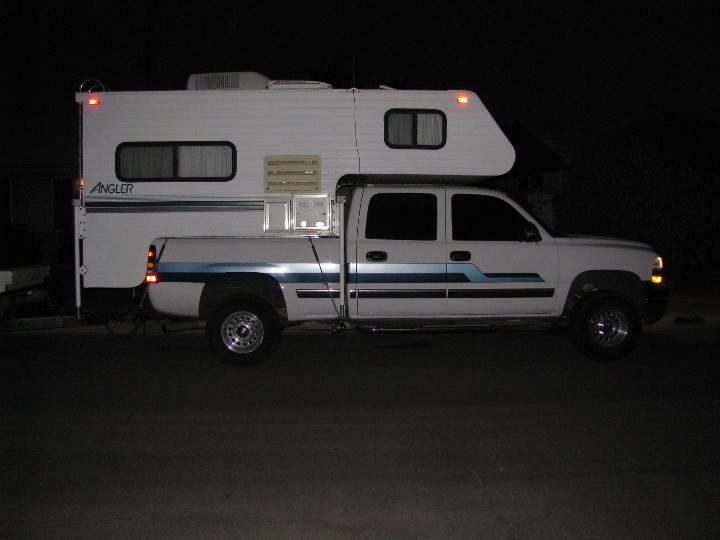

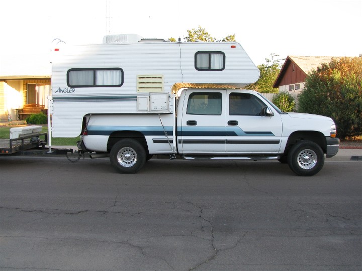

Bought Some Used Air Bags For The Back Of The Truck, Trying To Get Some Of The Sway Out With The Camper On.....We'll See How This Works Out........I Think I Need To Split The Air Valves.....
Post Icon Posted: June 05 2008,9:19 pm Post # 2 see this member send this member a private message  quote this post in reply
With 30# Of Air.....

That's what I was wondering, did the same thing with my first camper with one line, bad thing about that is when weight is shifted from side to side like going around a curve /corner, the air will go to the opposite side leaving one side low and you end up with a sag on one side until it recovers. I fixed that by putting one line to each side, was like night and day on the ride and handling!.. :good

Thats What I Was Thinking As Well. I Bought New Air Lines For It, So I Could Split them.

I Installed The New Airlines, But I haven't Aired Them Up And Driven It Yet.........When I Let The Air out, It Dropped Quite A Bit more That I Expected.....
