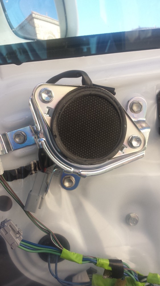

Here is what I started with. This is the factory tweeter in it's mount on the door.

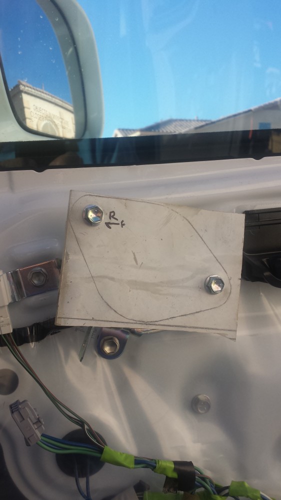

Testing the mount holes for the new tweeter mount

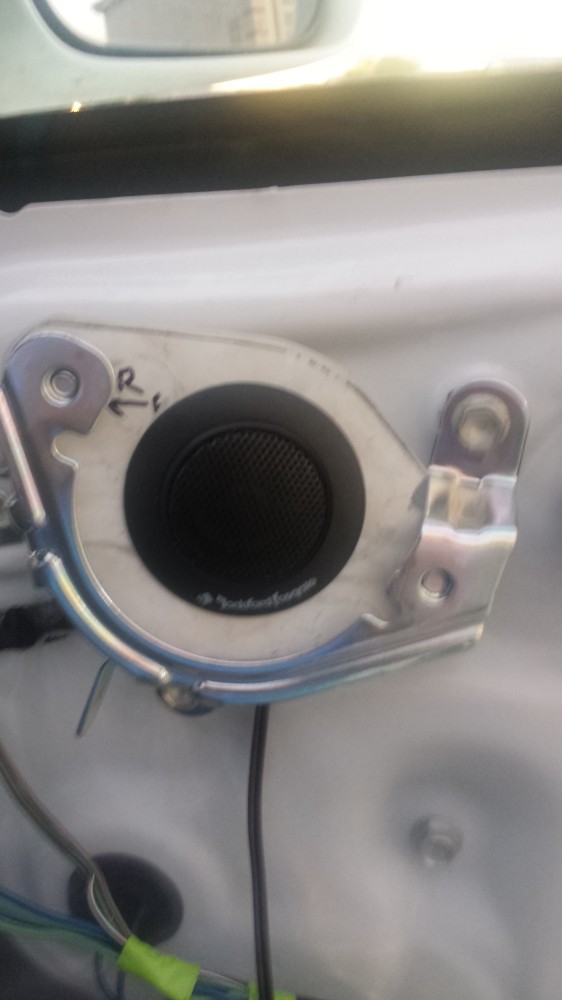

After cutting, Drilling and shaping here is the mount with the new tweeter. I had to mount it from the rear to clear the door panel.

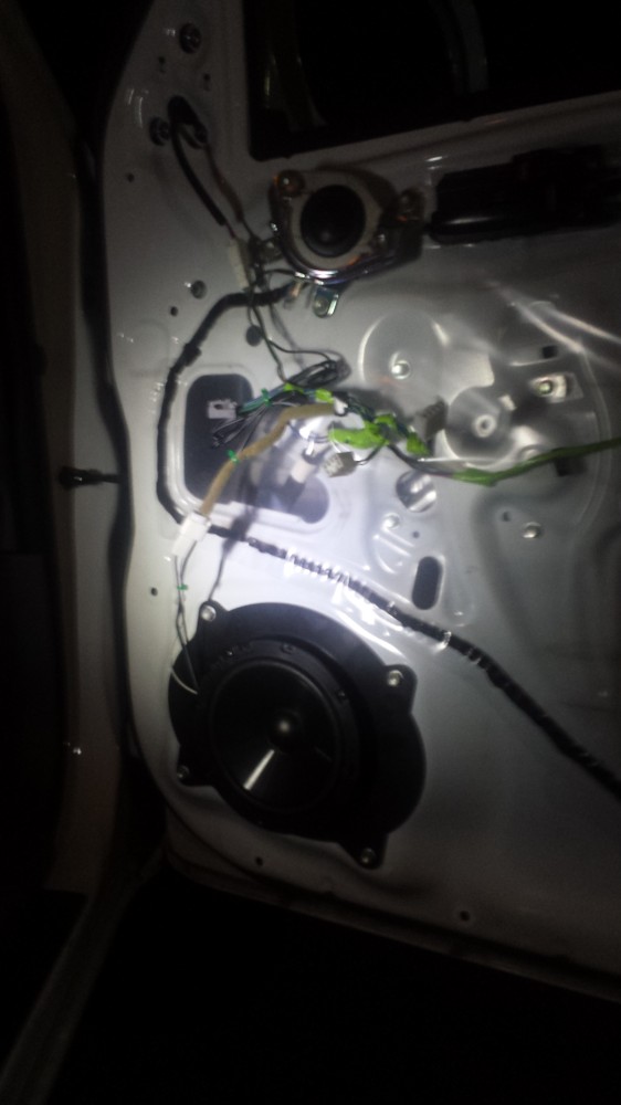

This both speakers mounted and wired, ready to put the door panel back on. It's a little dark but you can see how they are mounted. The original woofer was a 6x9. Rear doors had 5" speakers where now they are 6 3/4 front and rear.

Now!! You ask yourself. Self?? What did he use to make that tweeter mount?  :laugh
I used a piece of 1/8th inch Plexiglas that I had laying around. I figured that I didn't need anything to technical to mount the tweeters. To buy the mounts I still would have had to made adjustment to the tweeter hole to mount it since there are no 2 tweeter diameter the same. On top of that they would have cost at least $15 for the pair for decent mounts
