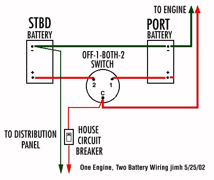

Can someone please explain to me how do you wire a second battery???  I just picked up a 6 Channel JL Audio Amp. and I want to run a second battery.  How do I wire this.  Is it just power cable to the new battery and ground, or new battery to battery one {Positive to Positve/Negitive to Negitive} or lastly Run both positive wires to the alt and the ground???

Mine has 3 in it. 2 are hooked together on the #2 side of the switch and 1 on the #1 side. I play the radio on the #2 side of the swich, so I know that I still have a good Batttery to start the engine on.

Thank for the Info... I stopped by a stereo store and a battery store on the way home and way able to pick up a hand out, So with that and the site Shueman found I should be good to go.
